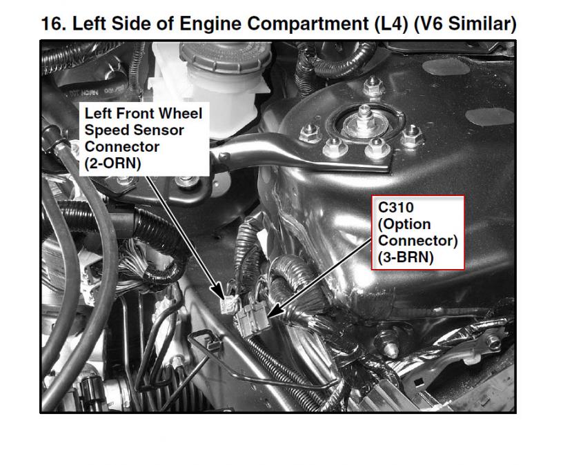

Here is a photo of the connector that probably is what you're looking for (connector C310).
In the fog light directions, step # 25, it says if the 3-pin connector is already being used by another accessory, locate the 3-pin connector taped to that other accessory's harness.
Attached Thumbnails Trouble installing fog lights on 07 Accord-connector-c310.jpg

Got the lights installed and operating tonight, thank you very much for the help.
what stopped me is that the missing accessory connector was indeed there but was so covered with this black dirt that it blended in with the surroundings. I had a devil of a time cleaning as much of that grime as I could out of the contacts. Thank goodness that local pharmacy was ble to give me an irrigation syringe (no needle) to flush the connector our with alcohol.
