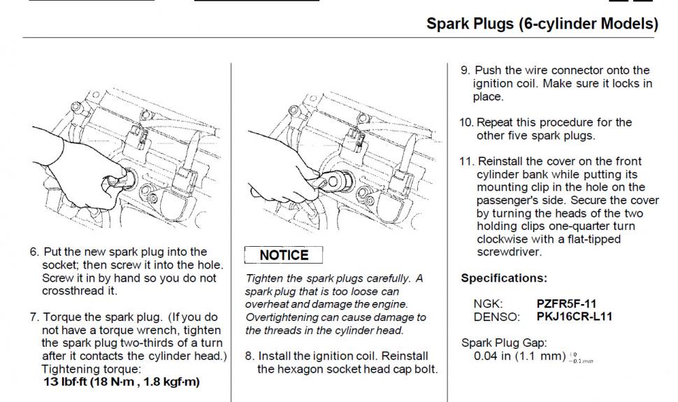

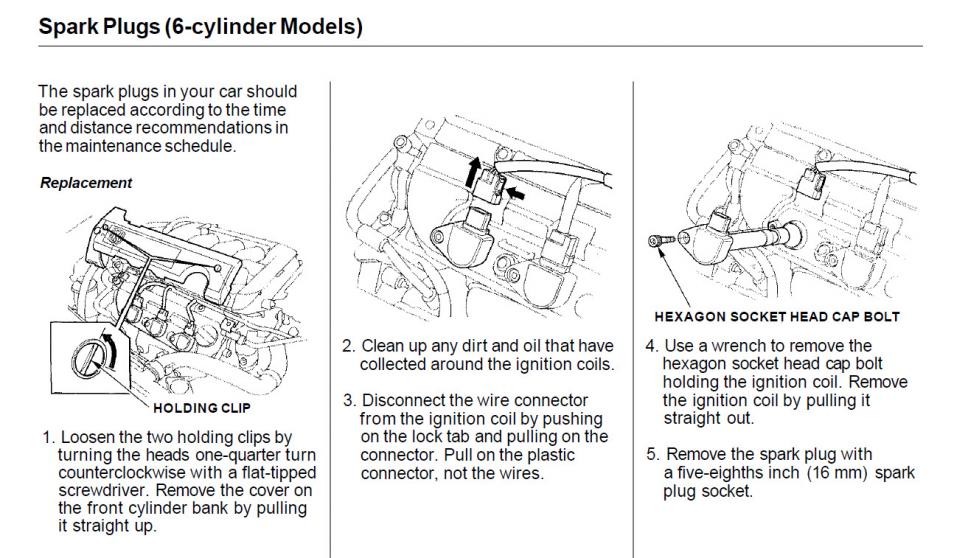

2. Spark plugs replacement may only be slightly difficult for some of the spark plugs near the firewall area. The 2001 has individual ignition coils, so there is no need to change out any traditional spark plug wires. See attached images from owner's manual regarding changing the spark plugs on the V6.
