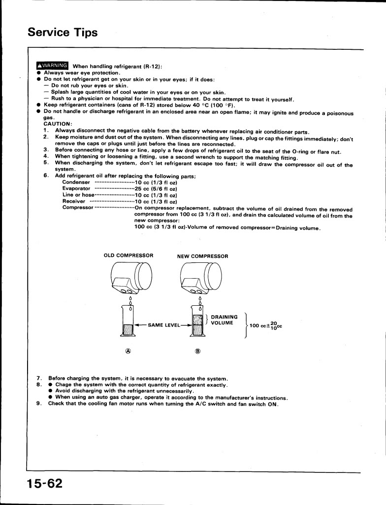

Heres what my manual says:
When it says per line, how many lines are there, I counted something like 8 or 9 so if that is then it is 8oz or so
