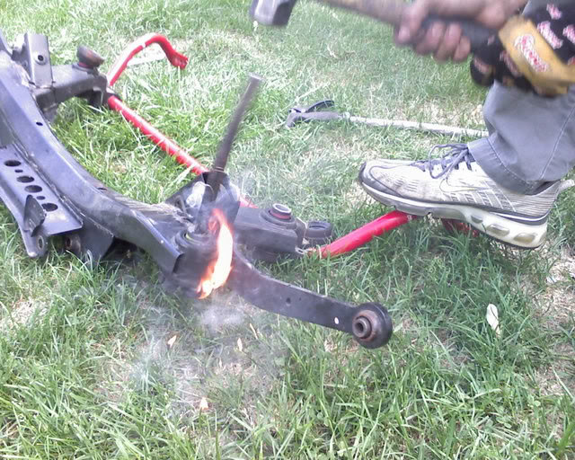

20 tons is good. burning them is more fun though to get them out. I think the tightest 1 on my car took about 15 tons of pressure.
Old Nov 5, 2008 | 08:04 PM
  #17
finch13's Avatar
Joined: Jun 2007
Posts: 7,381
From: St. Paul, MN
Default RE: Vibration over 30mph.
So after you burn out the rubber, how did you get the outer steel ring out?

That's not the bushing I'm talking about falkore24...the bushing is in this..........
He knows that... he just wanted to show you him burning them out on his car...
Oh,OK..........I remember needing shackle bushings in my Jeep,and someone suggested burning them (very messy-I CAN do that),but I elected to get new shackles because they were'nt much more and had new bushings.Plus the fact that indeed,you're only burning the rubber/still have to press out the outer sleeve.......
