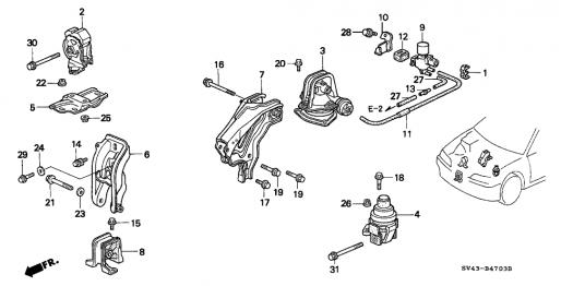

On 4-cyl automatic-trans only, the rear mount is vacuum-operated. Not the front one. It goes into it's "soft" mode when idling in-gear only.
Check out that one...
1. Find the solenoid (#9) on the vacuum line for that mount.
2. Warm up the engine.
3. Get a helper to shift into DRIVE, don't touch the gas pedal, & HOLD THE BRAKE.
4. Unplug the electrical connector for that solenoid. That should make the vibration noticeably worse. If there's no difference, then find out what isn't working.
Solenoid failed? Bad wiring to the solenoid?
No vacuum in that vacuum line? Disconnected vacuum hose?
Maybe the mount itself doesn't hold vacuum?
Seems that way to me. I believe part #28 in the diagram is broken from what I can tell when I get under the car and look at the mount. It's a connector to the arm part of the mount.
