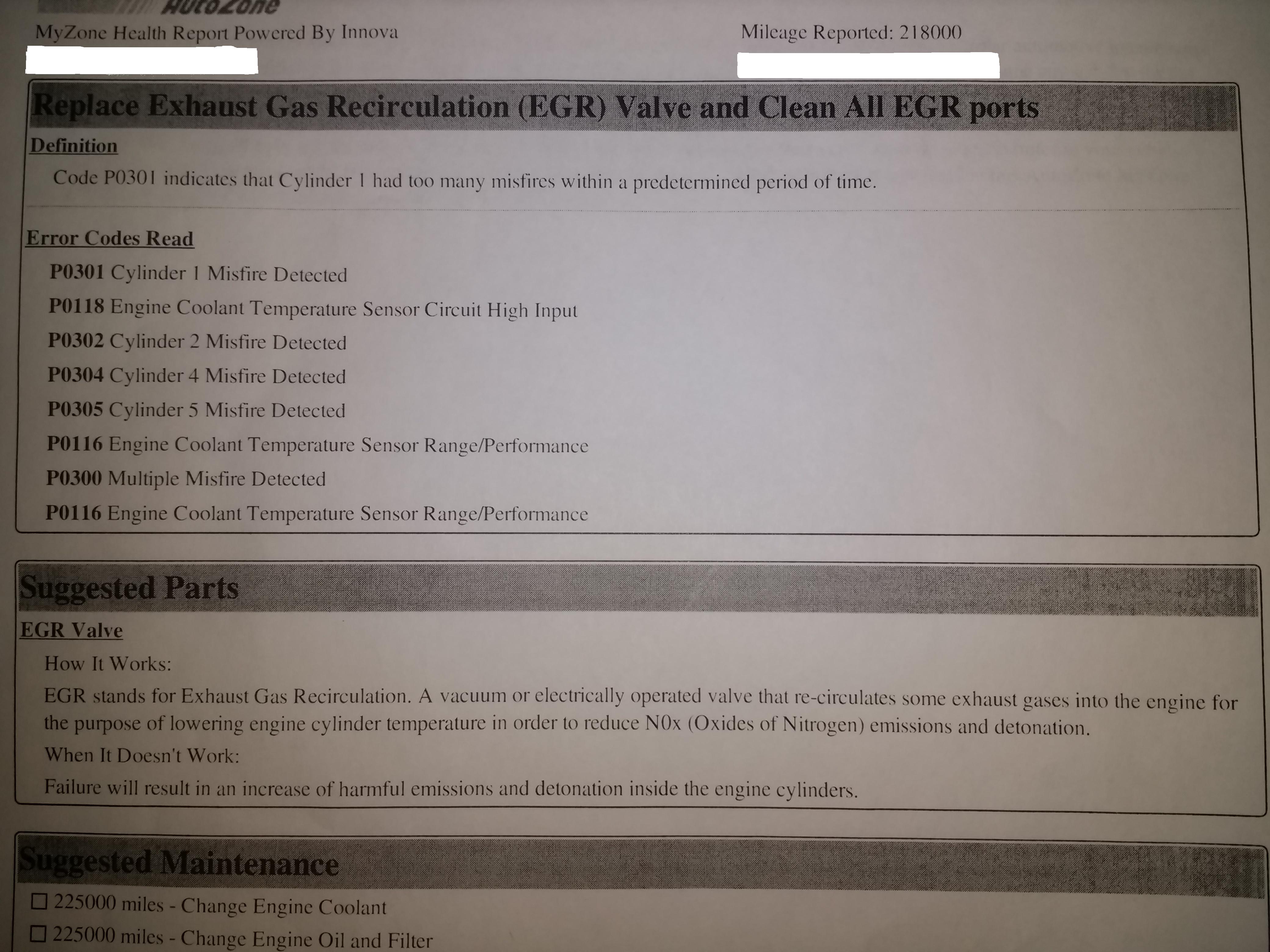

I'm not sure if I'm doing this properly, but if this image displays for y'all to see, this is a picture of the error codes report that I got from Auto Zone a few months back (and about 17,000 miles ago).
Evidently, I forgot to mention/neglected to notice that the EGR (Exhaust Gas Recirculation) Valve also needs to be replaced and that all of my car's EGR ports should be cleaned. A quick glance at the first few Google search results shows that an EGR will likely cost around $50? And I also must ask, is this EGR Valve something that I can likely remove and install myself? And if not, does anyone have an idea of time/cost for this replacement?
As always, helpful replies would be appreciated!

For spark plugs, go with NGK PZFR5F-11. That is what is recommended for your vehicle. I do not deviate from what plug Honda used in designing the engine. I'd replace the spark plugs if they are due for replacement.
I do not see an EGR code in your list, so I would not replace the valve or clean the ports.
The code for the engine coolant temperature sensor can mean the sensor, the wiring, or possible the PCM (engine computer) is bad. Replacing the sensor is simple.
Here is a video on replacing that sensor. The 2 wires going to the sensor should be green with black stripe, red with white stripe.

As for cleaning the EGR ports, that is specifically mentioned at the top of the page of the error codes report from Auto Zone. It states to "Replace Exhaust Gas Recirculation (EGR) Valve and Clean All EGR Ports." Do you think that I should try to just have the EGR Ports cleaned first, before buying an EGR Valve? Or would it likely be better/more practical to have the ports cleaned and the EGR Valve replaced at the same time?

As for the EGR code, that is specifically mentioned at the top of the page of the error codes report from Auto Zone. If you look at the first thing listed, it states to "Replace Exhaust Gas Recirculation (EGR) Valve and Clean All EGR Ports." And under 'Suggested Parts' just below the Error Codes, it lists the EGR Valve. The post above yours mentions that the EGR Ports needing to be cleaned is actually a more-common issue than needing to replace the EGR Valve is. So, like I asked him, do you think that I should try to just have the EGR Ports cleaned first, before buying an EGR Valve? Or would it likely be better/more practical to have the ports cleaned and the EGR Valve replaced at the same time?

You do not have a code for the EGR valve, so do not replace it. Cleaning the EGR ports is not a bad idea, but you also don't have the code for low EGR flow.
Right now you should address only the codes listed. Replacing working parts is asking for trouble, because aftermarket parts may not work properly. You risk wasting money.
I think replacing the engine coolant temperature sensor and the spark plugs are the first two steps you should take. This may fix all your engine codes.

I'm going to repeat this one more time. There are no codes listed for the EGR, so don't mess with it right now.
You only have misfires and engine coolant temperature sensor codes. Address them first.
Evidently, I forgot to mention/neglected to notice that the EGR (Exhaust Gas Recirculation) Valve also needs to be replaced and that all of my car's EGR ports should be cleaned. As always, helpful replies would be appreciated!
The OP mentioned in his 2nd post that it needed to have been done at 218K (had thrown a code), and the car now has 235K. It was throwing a code back then, and might be a "stored" code now. Or do you think replacing the plugs will get rid of an EGR code?

The picture of the readout is at 218k miles and only says to replace the EGR valve and clean the port. I just don't see the low flow or EGR lift sensor code. I think autozone is making that recommendation to sell an egr valve based on misfire codes.
I think that his engine coolant temperature sensor code is the first thing to address. The best way to test is to measure the change in voltage from the sensor while it is plugged in. I'm not sure if the original poster has the experience/confidence to do this test. He already has a new sensor, and I think that it is reasonable to replace the sensor based on his code.
The spark plugs are 2nd, because they are a maintenance item and there are misfire codes. I'm not sure if the original poster knows when the spark plugs were last replaced. I do not think that coils should be replaced, because his engine would no run if 4 of the 6 coils were out.
After those two items are replaced, then the codes should be cleared and then he can have any new codes read.
