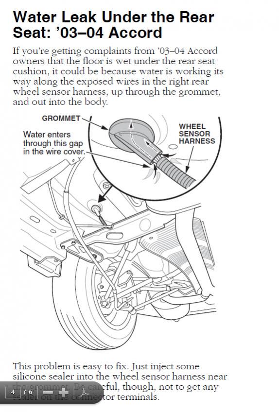

Trying to figure why my back passenger floor board is soaked when it rains? Its just the floor board rear passeneger seat are dry! Please help
Old Jun 20, 2011 | 02:57 PM
It may be water coming up from the wheel sensor wire harness/grommet. The fix is to inject some silicone sealer into the wheel sensor harness near the grommet. This is from the March 2004 Honda Service News; but, should be applicable to your car too.
