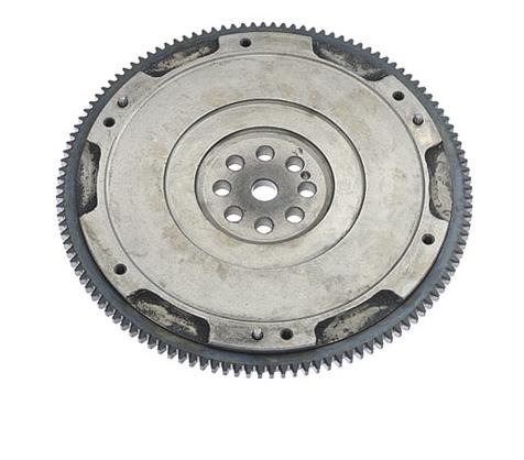

Think of it this way in a manual trans....it is like the "brake rotor" for the brake system - just backwards. The clutch disc is "clamped" between the clutch pressure plate and the flywheel to transfer the engine power to the transmission....it is a fairly large round hunk of steel...it also has the "ring gear" on it, this is what the starter "turns" when trying to start the car.
Should either replace with a new one or at least have a machine shop re-surface the flywheel when replacing the clutch.
EDIT: Looks something like this...a new one is ~$60

The flywheel the the metal plate that is bolted to the engine. It has teeth around the outside so the starter and turn the flywheel. This has to be installed on your car.
When the transmission is removed to do a clutch, the order is the engine block crankshaft, the flywheel, the clutch friction disc, then the pressure plate.
