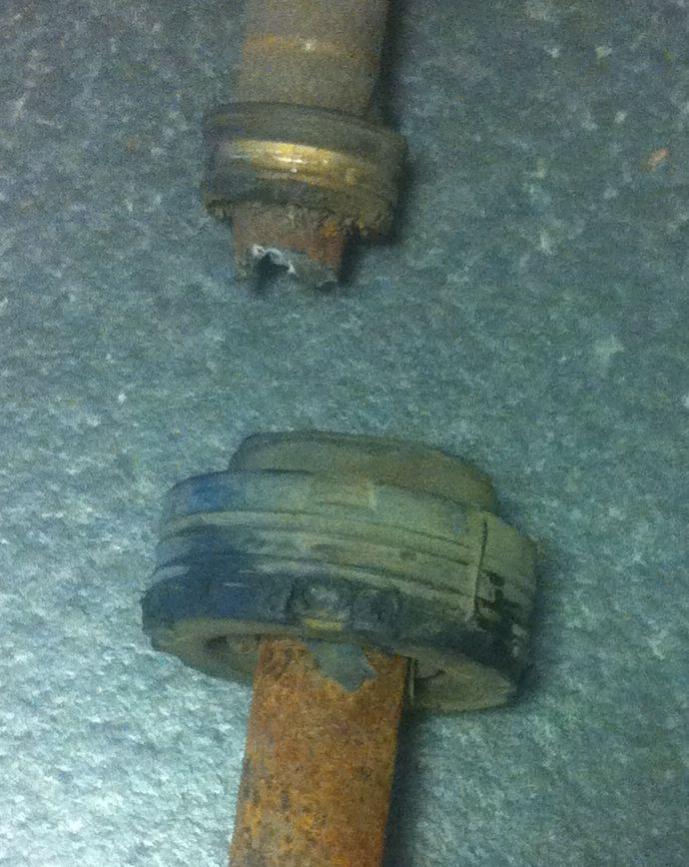

Thank you. I just got the car back. Attaching pics of the axles in case anyone is interested. I had both replaced as a precaution (I would be so paranoid if I hadn't). There is a lot of corrosion present - probably due to my location.

Corrosion combined w/ slight shaft imbalance leads to corrosion-accelerated fatigue. Once a deep pit forms, a crack is likely, eventually leading to failure. The balance ring may have exacerbated the problem by holding salty water on the defect.
Annual doses of corrosion-inhibitor (LPS or similar) may mitigate this in future. I believe there are places that offer this service, but no experience as corrosion is not a problem in S TX.

Thanks. The tech did say that the ring held water in there and probably made things worse but that the replacement part will not have that problem. I wonder if there should be a recommendation to replace these parts every so often if you live in a snow belt.

Hey, I just looked at your photos and I am surprised the broken had no paint left on it ad the other one did. Did these two come from the same car? That is odd and makes me again wonder if your car was in an accident and the other axle was replaced. There may be other reasons why one may have been replaced too.
Old Nov 13, 2013 | 04:43 PM
I can't see the fracture face, but anyway I'm not a metallurgist & probably shouldn't play one on-line...
A little crack that begins with some corrosion, will grow across the thickness of the axle over time. Might take weeks, during which time you might feel vibrations. When it gets to the point where the remaining connected metal is small enough, it breaks.
It might have started with a notch from being hit by something? Gouge through the paint with pliers or vise-grips? Who knows?? Seems like Goodyear wouldn't have any reason to mess with the axle that far inboard so I don't really see any way to blame them.
