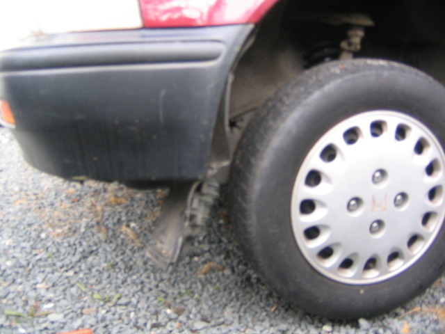

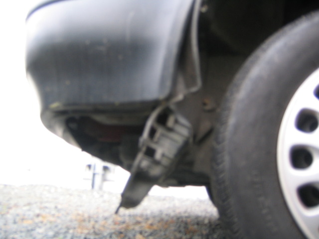

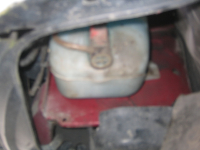

Indeed I can access the pump by simply loosening and pulling back the wheel well splash shield, as shown in the photos I decided to take and share here of the situation. No need to remove the whole fricken bumper or any "engine under cover" or take the reservoir out like that (fricken) manual described. Thanks PA.

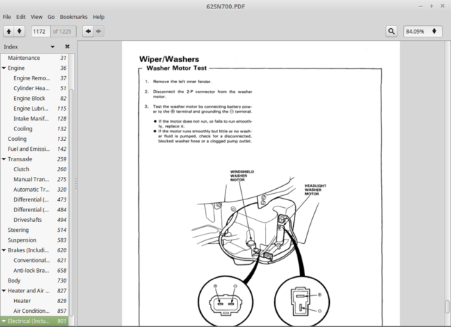

Also, I'd almost forgotten that I had another handy source of info other than that crappy Haynes manual, a CD with a bunch of 4th Gen Accord service info that somebody
had sent me in the past. I just took a look at that and it describes to remove the "left inner fender" and also describes a method to test the pump motor -- to "connect battery power to the positive terminal and ground the negative terminal" (screenshot below):
I haven't tested the pump motor as I suppose I could if I was really clear on how to how to go about it as it describes. I also notice that description also mentions a headlight washer too which my Accord did not come equipped with; mine just has a wiper washer, but actually located on the reservoir where the drawing shows the headlight washer pump motor.

Well if the pump is out, simply put power and ground from the battery to the terminals and see if it runs.
You could dip the inlet into a bowl of water and see if fluid "squirts" out of the outlet or simply feel it "hum".
Also with a volt meter, when someone is "pressing/pulling" (can't remember how it works) are you getting power and ground to the wires.
