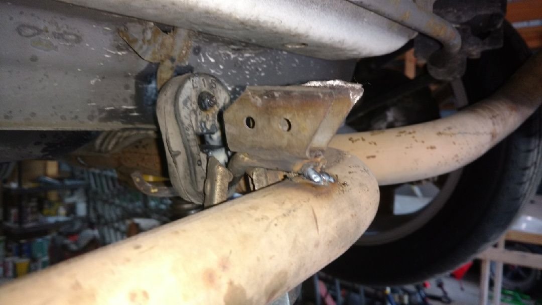

reuse these

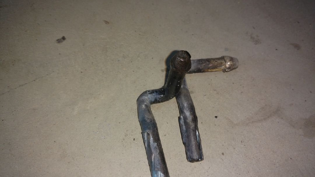

rebend them
like this

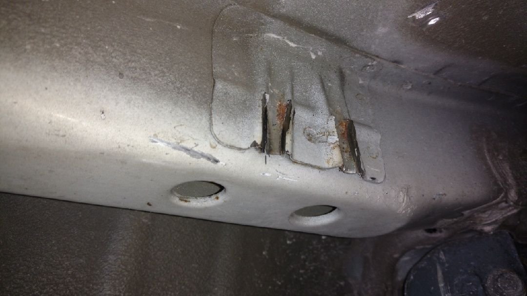

weld in the rear. The spot is already there.
I reused the 4 banger center mount, just because

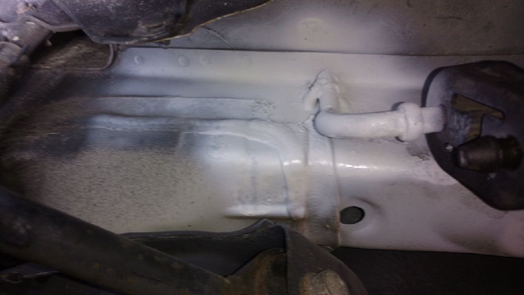

Sprayed some white to protect the welds,

The stock single exhaust uses two supported areas. The dual uses four. I used five It's a shame they don't share some of the hangers, shame on Honda. The two hook hanger that was stock, I removed and reused. I rebent them to work at the back of the exhaust/muffler exit. There is a place on the frame rail where the dual mufflers would attach. I welded the hooks there. I painted the welds. I used the center support that the single exhaust had. I didn't have to, but I had it so . . . For the front of the mufflers, I used some old Fox Mustang hooks I had. Cut and welded them. Some round steel would work, not hard to find. I cut the factory turn downs off the mufflers, since I got this used system from a Sedan. Adapters then the stainless tips. Used an adapter from the y-pipe to the factory exhaust pipe coming down the center of the car, there is a difference in size. So the adapter took care of that. Painted everything, 4 1/2 hours, about $65 . . and in my opinion, looks much much better. More like a Couple should look . . but still 4 banger MPGs! It's a 5 speed car, no looks the part. No rattles, everything is perfect. Give it a try. Also . .there are more pics, posted, waiting on approval.
