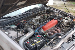

i have a 1992 honda accord ex-r and i got a cold air intake for it, the problem i see is that it sucks hot air in from the engine compartment, any suggestions>

sorry i didnt really explaine it well i was in a hurry in class,its just a cheapy cold air intake, mr.gasket i believe. but the air filter is like right near the wheel well,what im wondering is if i drill holes in the wheel well to try to get cool air from atmosphere, and put a mesh screen over it, would that be a good idea or no? i know that some dust would go into the filter because of the dust comming off the wheel but i mean all its doing now is sucking in hot air from under the hood,which pretty much defeates the purpose right? i tried reading up on it but i couldn't find any usefull information

If the filter is visible in the engine bay then you DON'T have a cold air intake you have a short ram.

yeah okay sorry man your right,this is my first honda haha bare with me. mine looks egzactly like the first picture there, but all it does is suck in hot air from under the hood. so that would pretty much defete the purpose right, isnt the whole point to increase volumetric efficiancy? im just wonderin if drillin holes in the wheel well right under the air filter would be a good idea or not,

Drilling holes isn’t gonna do anything. It doesn’t defeat the purpose you are sucking in more air the OE intake was so you have gained in performance. Just your intake charge is still hot air.

okay i gotcha, thanks alot for your advice man greatly appriciated. i understand what you are sayin, i just thought it could bring up the volumetric efficiancy a bit by usin cooler air mixture but no use drillin holes when i dont need to.

Yes IF your intake charge was colder you would have more air packed in. But I have owned a short ram and CIA there isn't that much of a diff.
My cb runs better with the CAI but it didn't run bad with the short ram.
