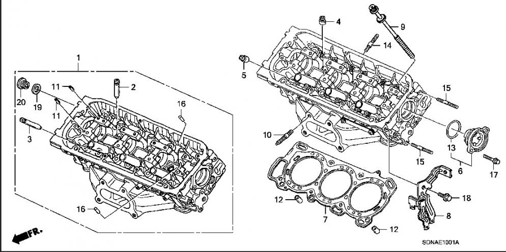

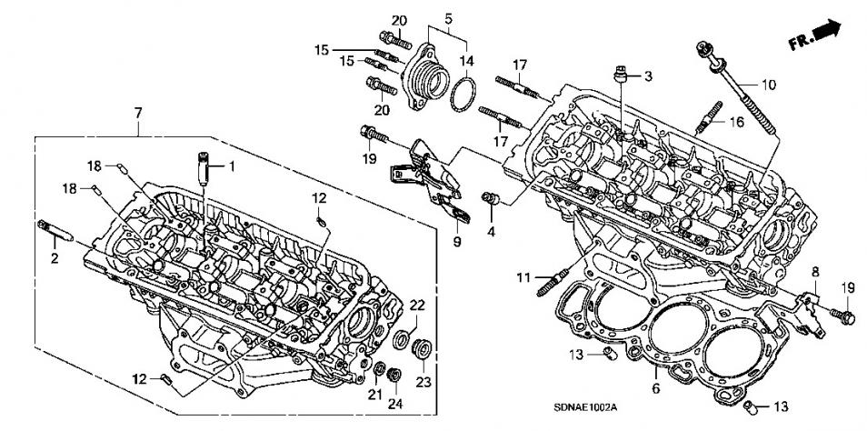

Posts: 7,101
The way the 7th gen Accord V6 set-up is: there are two separate cat converters attached to the respective front and rear cylinder heads. A J-pipe is attached to the two separate cat converters, which then run to third cat converter. Then there is still the cat-back exhaust system.
The J-pipe is what a lot of people have done already on their 7th and 8th gen Accord V6. It is not rare.
Current, Honda Accord V6 exhaust system are not like the days of old.
Attached Thumbnails Headers for 2003 accord 3.0L (4 door)-accord-v6.jpg   Headers for 2003 accord 3.0L (4 door)-front-cylinder-head.jpg   Headers for 2003 accord 3.0L (4 door)-rear-cylinder-head.jpg   Headers for 2003 accord 3.0L (4 door)-cat-converters.jpg
