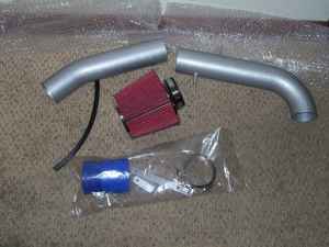

if you use this AEM bypass valve you reduce the heat soak (b/c its really hard to completely eliminate heat soak) and hydro locking. This AEM one ^^^^ only opens when there is water suction otherwise it stays closed
something like this. This just acts like another little filter and you still get heat soak just as SRI
