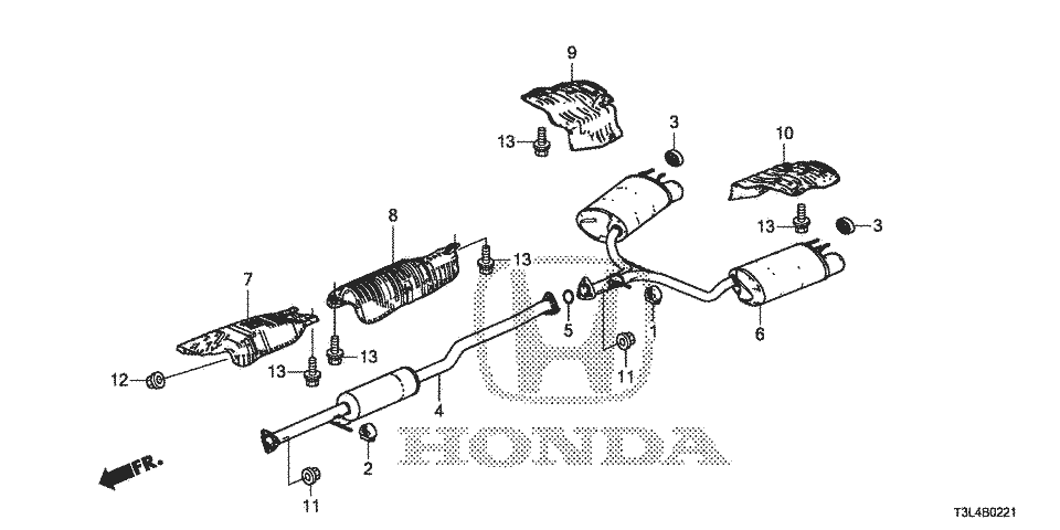

Can anyone tell me if my Accord V6 Coupe (2014) is true dual exhaust? All the way from the manifold to the tips or do they quickly merge into one pipe then branch off again just short of the rear bumper?

Highly unlikely. I've never seen the underside of a 2014 Accord Coupe V6, but every FWD Honda/Acura V6 I've seen since the 1990s has used a "J" pipe to combine the exhaust into a single run down the middle of the car only to be broken back out to two mufflers via a slightly offset "Y" joint (which effectively alternates mufflers for each exhaust impulse).

Looks like Shipo's right again.
Attached Thumbnails 2014 Accord Coupe V6 (Exhaust Question)-2014-2dr-v6-exhaust.gif
