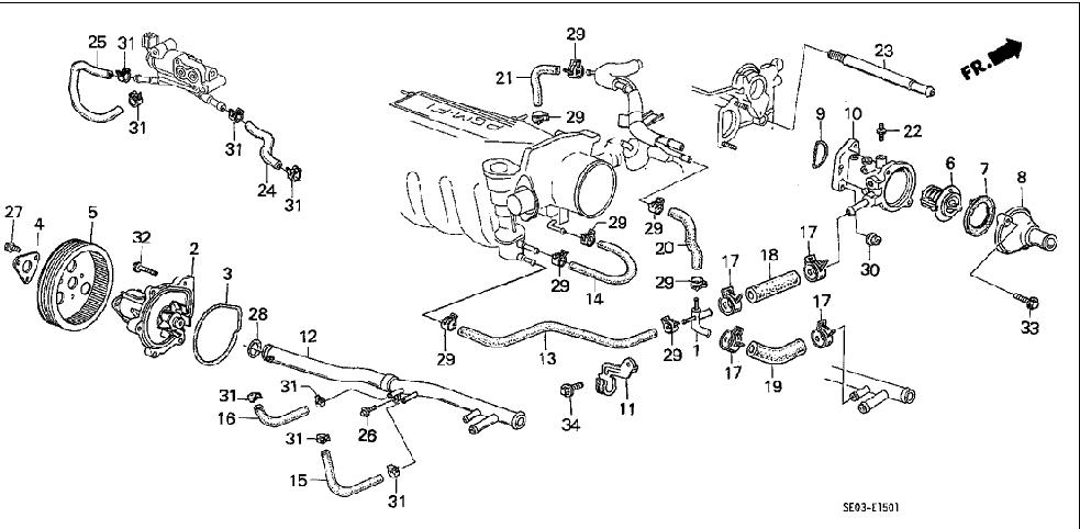

I went out and "re-freshed" my memory - I'm going to guess it is the lower of two small/short hoses coming off @ the t-stat housing heading towards the firewall.
Remove the intake tube that runs to the air filter. There is a set of ~8 vac lines right above those hoses - there should be enough "slack" in them that you don't have to remove them.
From there - I would remove the upper small hose, plan on replacing since you have it off, why not. Then go for the lower one.
I'd get new hoses and "worm" clamps. Once the old ones are out, the end that is not on the t-stat will have a bit of "play/movement". Spray a bit of lube either on the metal connections or lightly lube the inside of the new hoses. Install the new hose to the t-stat side first, slide it as far as you can. Then attach the other side - once you kind of have it started, slide the hose back off (not all the way) the t-stat side and set/seat the hose. Not sure if you get where I'm going with that - but putting it further on the t-stat side gives you more room for the firewall side - then once some what connected you can back it off the t-stat side to set it......don't forget the clamps
Position the clamps in such a way that you can get to them with a 1/4 ratchet and a 5/16 or 8 mm socket. Tighten all four clamps (two on each hose).
Slide the temp control (inside the car) to MAX heat and turn the blower OFF. Open the bleeder on the t-stat housing. SLOWLY add coolant to the rad until a good stream comes out the bleeder. Close the bleeder. Replace the cap to the FIRST CLICK ONLY - this is IMPORTANT!
Start the car and let it run - check your work, if there is a bit of coolant leaking from the new clamps slowly tighten them. Keep an eye on the temp gauge and at any point it goes above 1/2 or gets towards 3/4 shut the car off.
Let the car run until the fans cycle at least once, I got for twice but that is me. This time of the year, it could take 15~25 minutes. Once they do cycle, shut the car off.
Remove the rad cap - WARNING - THE REASON FOR ONE CLICK ON THE CAP WAS BECAUSE YOU DON'T BUILD PRESSURE IN THE SYSTEM - DO NOT BURN YOURSELF WITH HOT COOLANT. Top off the rad if needed, check the over flow tank. replace cap all the way.
Done ......oh, put the intake tube back on
For your other question. Lots of parts on the 3rd gens (86-89) interchange....some don't. As far as the hood (metal), any 3rd gen hood will fit (2, 3, 4 door - DX, LX or LXi). Note that the plastic "trim" -right where the hood and bumper "meet" is different - for that you will need one from a 88 or 89. Also remember that the stickers under the hood - vac line diagrams and spec's could be different but they fit.
EDIT - wow this got way longer than I thought....again I like the 3rd gens.......and yes, I'm not a good speller but I hope I got close enough for you to understand what I was trying to say/type . If you were close by I'd be more than happy to help out. In the pic I'm talking about 18 and 19.

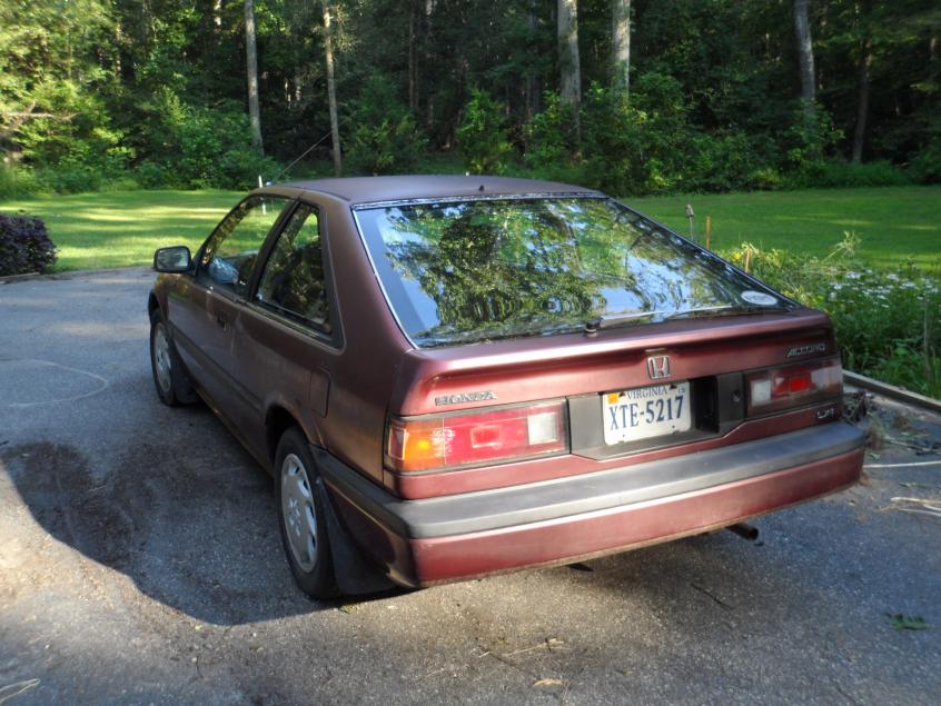

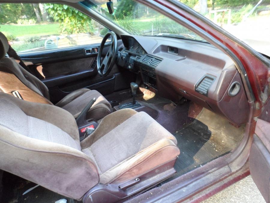

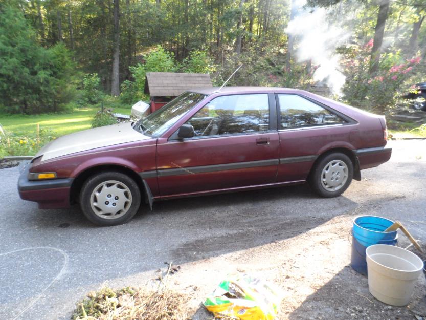

Here a few pixs of 88 Accord HB. I washed it up and then took the pictures. I looked under and all around and I did not find one spot of rust. All the doors and frames around doors free of rust. There are no dents scratches and paint job is faded but lower door frame has bright clean burgandy which is original color. After sitting for 2months it started on first key turn.
Thanks

Wow, that is a nice 3rd gen - low miles.
You are coming up on a timing belt change, unless you can confirm the last one.

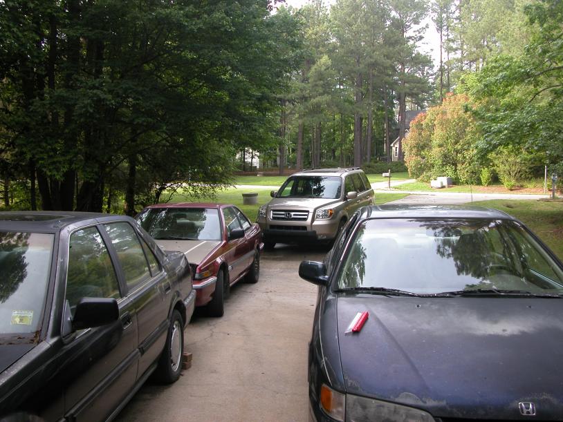

The really funny thing - my 89 LXi 2 dr has the same paint set up.....even down the to the hood color .....I do have one "gold" headlight cover on you. Oldest went deer hunting with the car - he hit the deer but didn't "take it" so it got away . See pic, behind the 88 LXi (recently sold) and infront of the Pilot.....again it is a coupe but close enough.
I had just bought that one for him to replace his 87 LX 4 dr 5 speed because it got rear-ended. I had not sent it to the bone yard at that point so we swapped the hood and one headlight from the 87.
