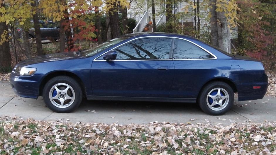

Here's a picture of the car in question.

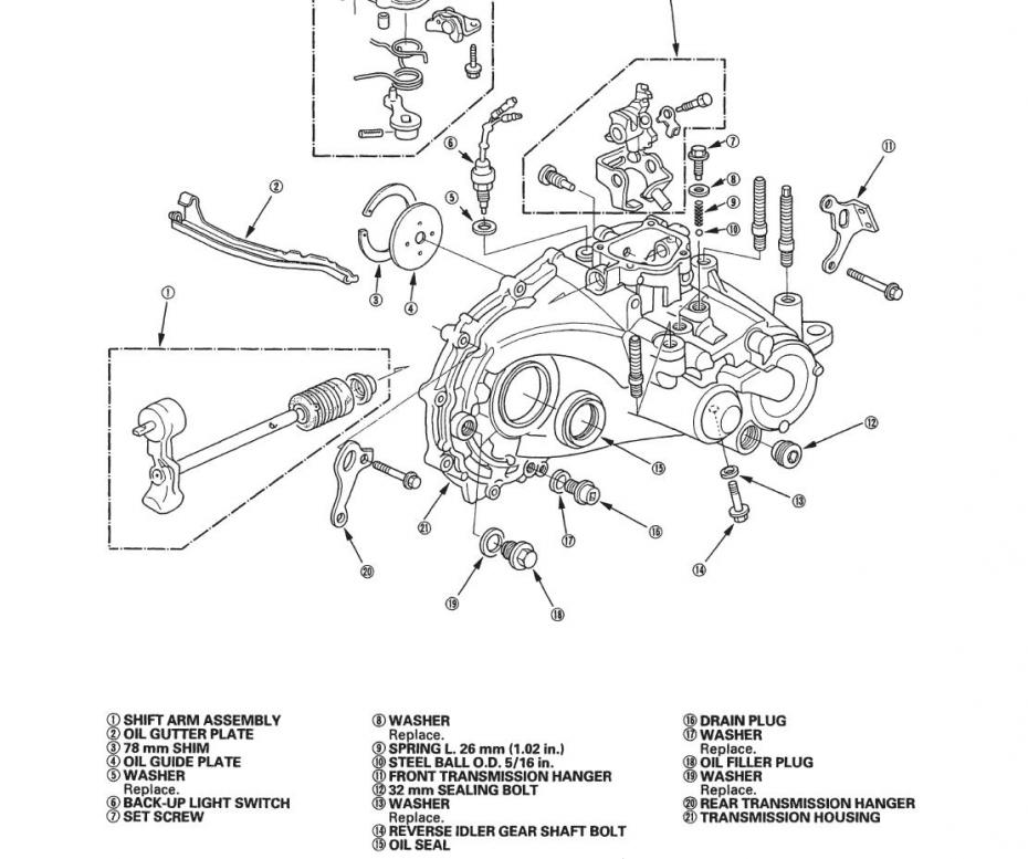

I'm with Jim....if the last person jacked the car up from the pass side only and filled it while still on the jack/stand....there you go.
On the older ones (4th and 5th gens) there is another plug some will use that is the wrong one and over fill it but not so on the 6th gens.
