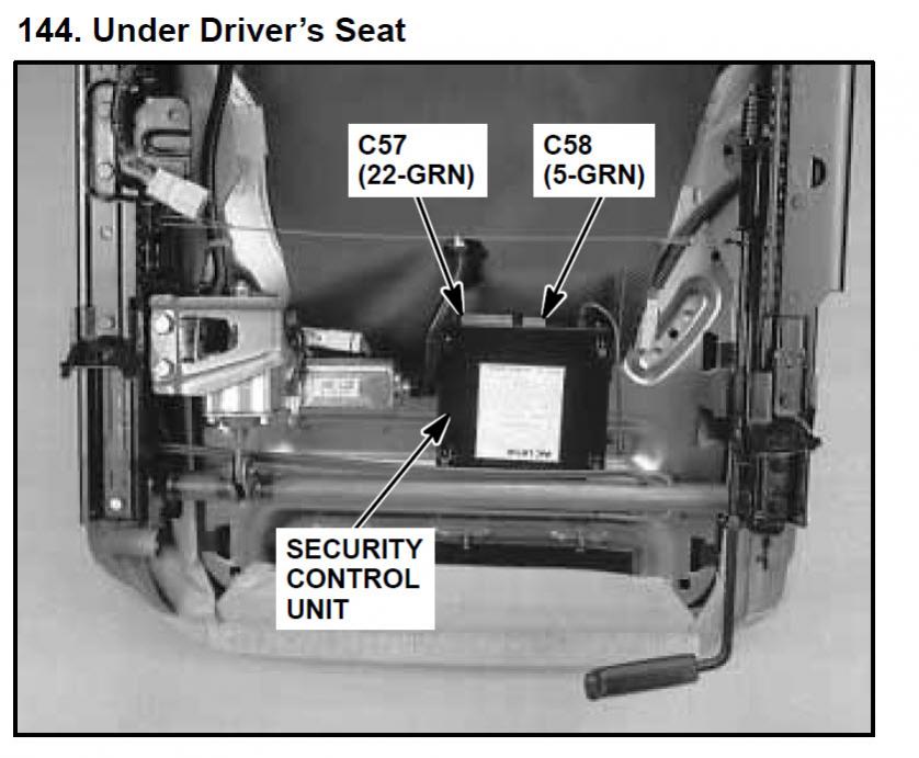

2. For the 95 EX V6, if it came with an optional dealer installed Honda security unit, then you could just add the Honda remote transmitter referred to in this link: http://www.tegger.com/hondafaq/misc/98-011.pdf//
It probably does not have it; normally that unit is installed under the driver's seat (see attached pic.).

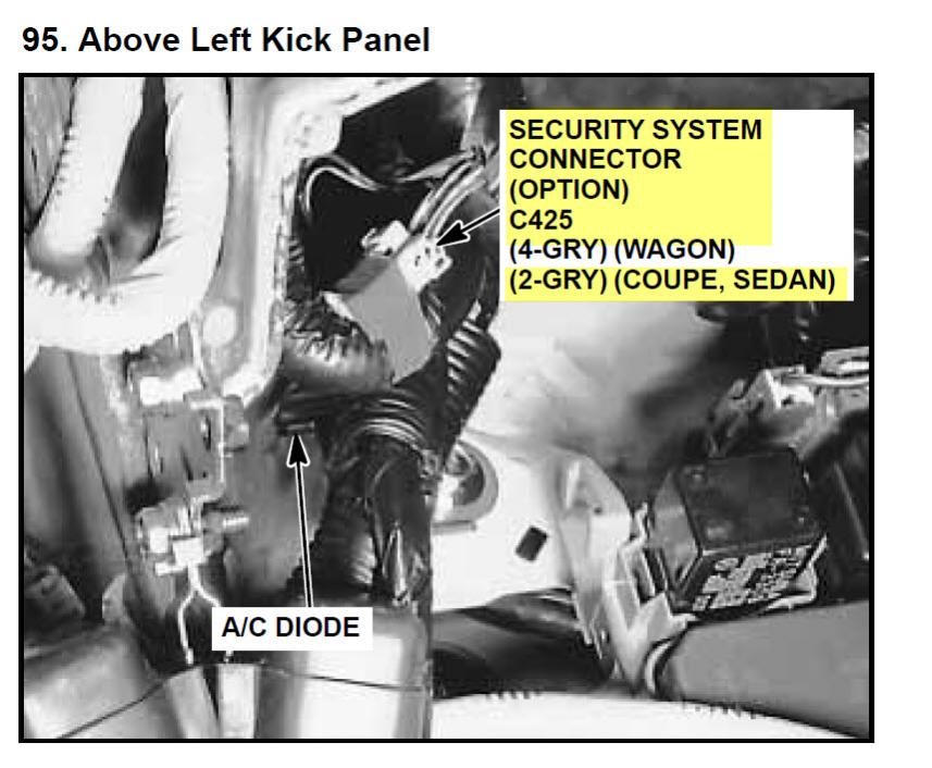

3. If it doesn't have the optional dealer installed Honda security control unit, you can just get any aftermarket remote keyless entry system.
Basically to install an aftermarket keyless system:
Aftermarket system
  • Power wire (+) to car's power source that is always hot
  • Ground wire (-) to car's ground
  • Lock wire to car's Blk/Wht lock wire (Blk/Wht is a wire with black colored insulation with a white stripe running through it).
  • Unlock wire to car's orange unlock wire.
Located behind the driver's kick panel is a 2P gray connector (Connector C425 - see attached pic.) with the Blk/Wht and orange wires. It will be unused and maybe taped up, if the car doesn't have the dealer install security unit.
The Honda door locks are "negative trigger", so when you get an aftermarket keyless system, you would use the instructions for a negative trigger system.
Aftermarket system
The Honda door locks are "negative trigger", so when you get an aftermarket keyless system, you would use the instructions for a negative trigger system.[/QUOTE]
