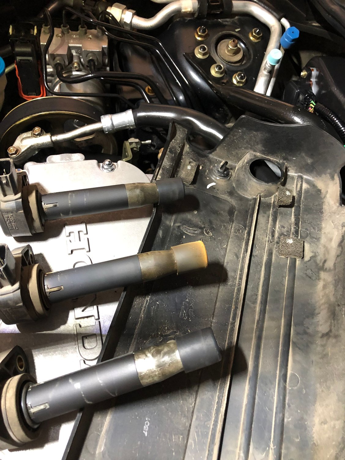

It’s the v6. Can someone please confirm it is a timing belt and not a chain?
So I pulled three of the plugs and they looked fine. At that point I figured I might as well just change them for good measure so I will inspect the rear three when I do.
Question. Why is the middle ignition coil orange compared the the other two? Is this okay or should I replace? Pic below
Ignition coils

A few comments:
  • The engine has a Timing Belt; the belt change is due every 105,000 miles (I strongly recommend the water pump, tensioner, cam seals and front crank seal get changed at the same time). Honda used to have a 7-Year time limit on the belt; this was dropped right about the time your car was built.
  • The middle coil was probably changed; it is not unusual for one or two coils to have failed by the time 188,000 miles have shown up on the clock.
