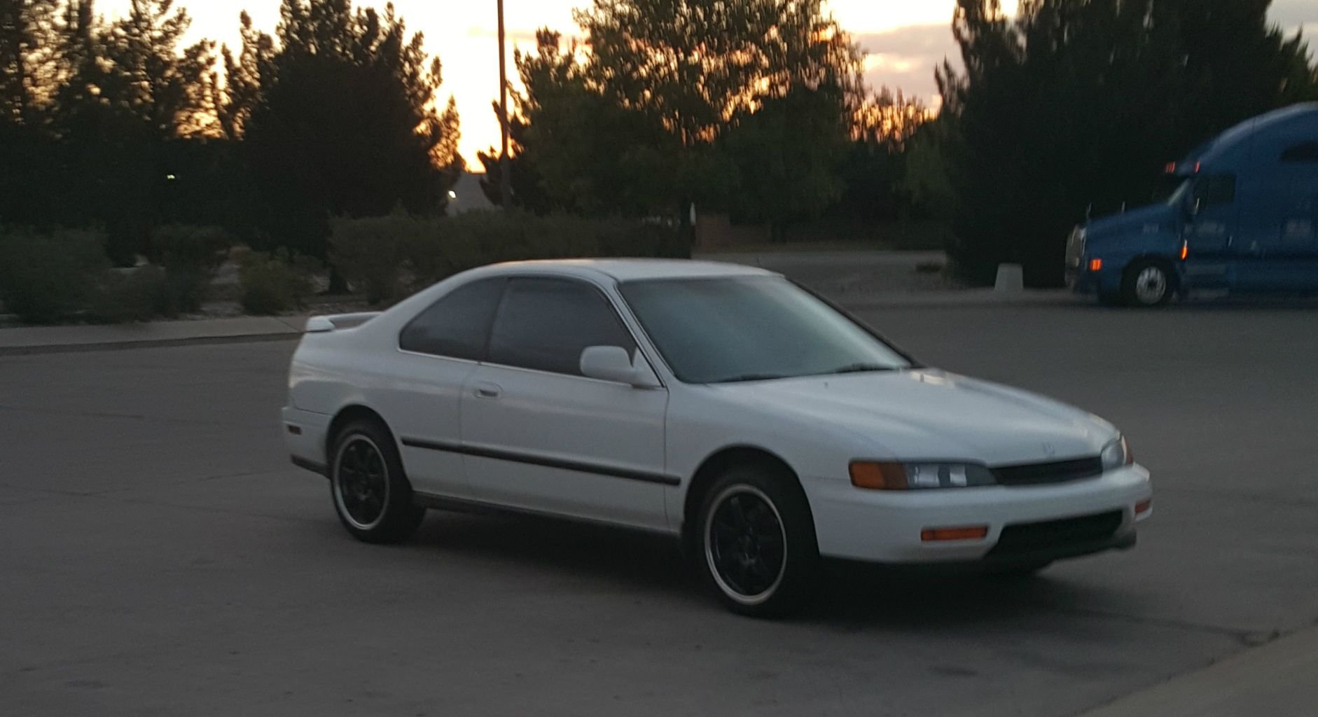

Hello my name is Jordan. I have a 1994 Honda Accord LX Coupe. My honda had a very long life at over 300k. After this photo was taken on April 19th 2015 the motor went out and had no compression in 3 of the cylinders. Long story short and the car has been sitting for 3 years and just recently she has been pulled from her hibernation and returned to the garage. I have a budget of about 3k for my build. I am very determined to get this car road ready again but after inspections its gonna need a lot of work done. The F22B2 motor is still fairly clean but could use a rebuild anyways for the well being of the engine. I do believe this car will need a complete rebuild but I have a overhaul manual for the car and I want to try to get it started again because I am in need of a car.

Welcome. That's a good looking 5th gen coupe. I'd probably look for a good JDM engine to be honest. I only say that, as you'll have 1200 to 1500 in just rebuilding your engine, with a good part of that in machine shop time alone. Depending on where you are, going thru the head will run you 350 to 400. Then add in the cost of honing the cylinders will be at least 300. Note, I got those prices from my local machine shop from when my son had those items done to his 98 Civic engine. This didn't include polishing the crank (he bought new), getting a complete gasket kit, bearings, rings, oil pump, timing belt and tensioner, or other miscellaneous items just to run it.
He did replace the engine mounts on it, since it has 230K miles on it. Also, he had his high amp alternator seize from sitting for 8 months while he gathered up the parts to actually rebuild the engine.
In your case, I'd also look at the condition of the brakes (front and rear), exhaust, and tires (in particular age of them), but also for any funky wear patterns, and maybe do a trans fluid swap. Basically do a good look over of anything and everything, including the lights. I only mention that last one as I've had vehicles sit for 6 months and have had funky things happen.
