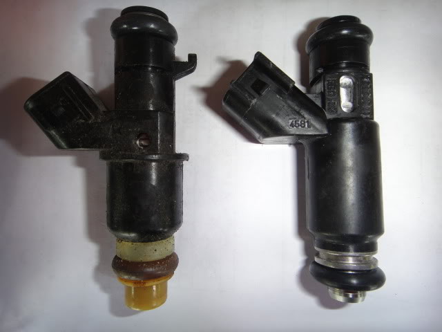

comparing stock injectors to the RSX
Deatschwerks 800cc RSX injectors
