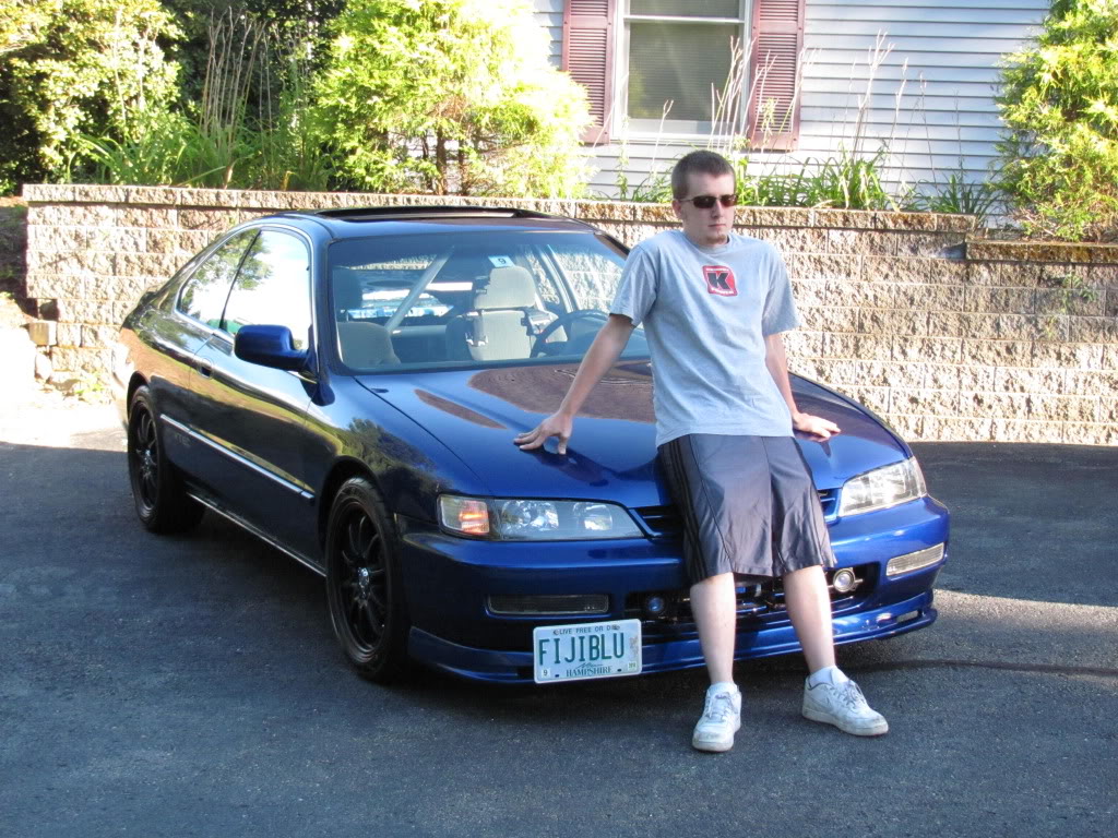

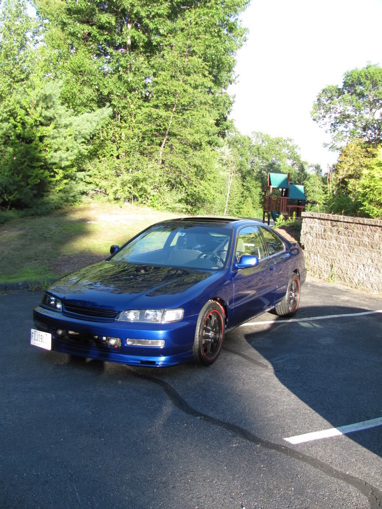

Heres some pics of what it looks like now:

I have always like the looks of your accord. Pics are good except for the funny lookin kid standing in front of the car ..lol

Hi Rice..and Hey Ryan, what do you think of his Hood Ornement
