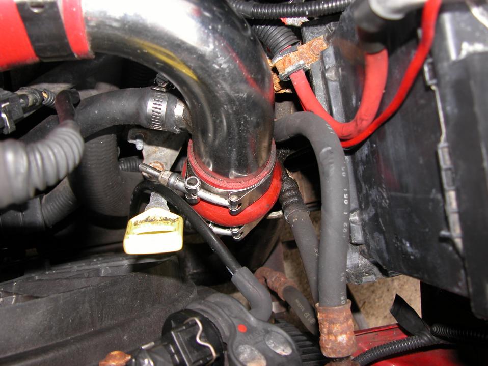

I have been spending all of my time looking at the intake tube from the air filter to the turbo for air leaks....my dumb *** self managed to knock the tube from the intercooler to the TB off. How I have no idea, so again I have to walk away and not try to work on things.
I'm not even going to try to put it back on today, sorry Cam, as I feel so bad.
I'll just get on my new/used riding mower and mow the weeds down.

Added a pic of my stupid miss......

Just so I can put an end to this and make sure that Cam knows I didn't destroy his car.
Once I put the intake tubing back where it needs to be.....guess what, it runs like a dream again. I realy want that "hammer to head icon".
Also the "slight break up" I thoought I felt in the higher rpm's is gone, guess without three cracked plugs it would be better
