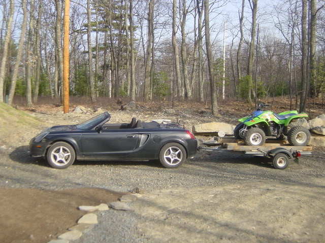

Here's the package I used to tow:
Here's what I'll be towing now:
The Trailer: It has a galvanized welded frame and is slightly larger w/ a longer toungue. The old trailer was small and had a bolt up frame (I built it from a kit). The trailer I'll be using (pictured below) now has a pressure treated plywood deck painted black, wheel chock and toolbox (for storing straps, etc) bolted to the tongue. I also replaced all the wiring, and installed new lights. Oh, I also painted the trailer fenders w/ the same flat black paint I used on the deck. I just had the wheel bearings packed, and the suspension was inspected by a local shop. I drilled two holes in the deck where I insert two bolts w/ butterfly nuts used to attach the 4 foot steel folding ramp during transport.
The Car: 2002 Honda Accord EX V6. 117k mi. Nice car; I got it over the summer. I traided my TL1000R and the old Kawasaki Mojave (pictured above) for it. I traded the MR2 Spyder (pictured above, but you knew that, right?) for the 2003 Honda VFR (Yep, you guessed it; pictured below). Anyway>>>>> I just had $2000 worth of work done to the car. I had the tow hitch installed, along w/ wiring harness. Four brand new tires on a set of five spoke 17" wheels (16's pictured below now for sale-$200 plus shipping), coolant flush, oil change, tranny flush, new brakes, new plugs and new timing belt/water pump.

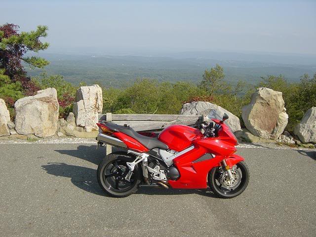

The Bike: My 2003 Honda VFR. As I said, I traded my Spyder for this baby. I made the trade this past summer and I have no regrets. The bike was perfectly stock and only had 211 miles on it (currently has 3400 mi.). The Spyder's realistic book/selling value was approx. $6000, so a straight up trade seemed like a good deal to me. I had been shopping for a VFR for three months before finally getting a deal like this. I've since removed the passenger pegs and grabhandles and added the seat cowl that just arrived the other day (Thanks Daniel Paul! Buy stuff from him and you'll get it two days later...) That piece really cleans up the rear beautifully, and I've been lusting for one bit didn't want to buy one new. I wired in a cigarette lighter adapter w/ an extention cord so I can use up to three devices within ten feet of the bike (cell phone/Ipod/GPS, etc). Other than that the bike is basically stock. When I get to Florida, I'll unload it, start it up, put on my gear and ride it to the beach.
