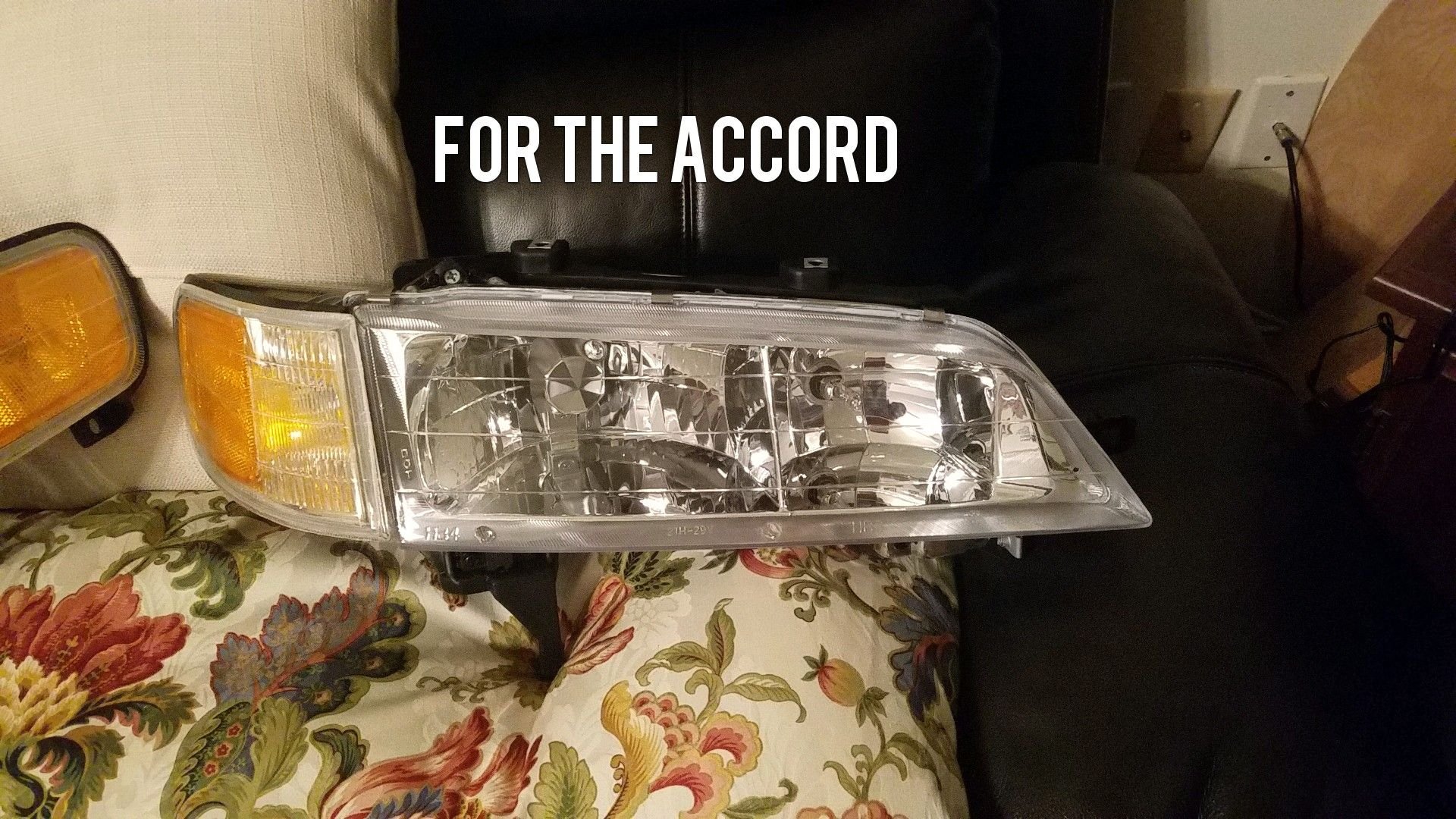

Ordered new headlight set today, had to get the stock looking ones, because the ones with clear corners like I wanted are evidently out of production. I wasn't paying $130+ for projectors, and I don't want dark tinted ones, so this is what I settled for.
(I know they look tinted in this picture, but they're not.)
Glad to hear you've got the other issues taken care of, so you can really drive it.
As for the headlights go, stock never goes out of style.

One side of the set. The in-picture caption was because i originally texted this photo to a friend.
