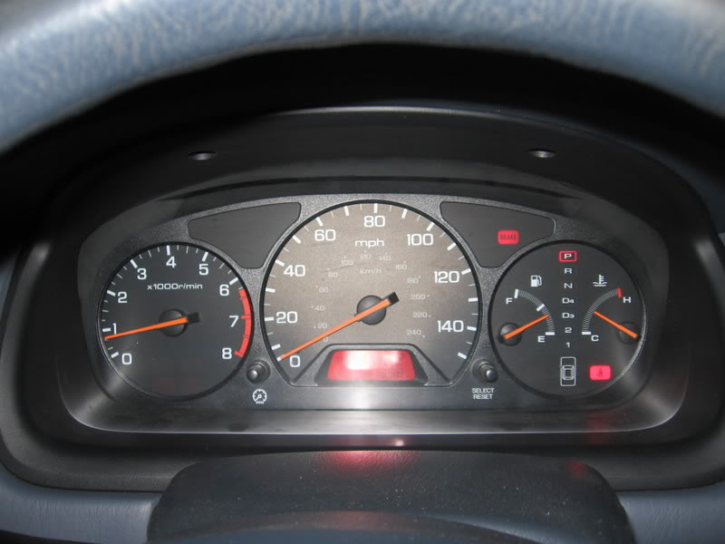

ok ok ....i dont know if most of u guys dont care about this mod but i have changed all my gauge light, ac control and odometer , and my digital clock from a greenish color to a more eye-pleasing red( so it would match my new cd deck)
**i will post pictures as soon as i can take the, porbably within the next day or two...........unfortunately i didnt take pics before the mod(oem style)
so if someone in here has a 6th gen accord please post up pics of ur interior lighting so we can compare****

how it looks like during the day
http://i126.photobucket.com/albums/p...g/IMG_1782.jpg
do u see a differnce in my corner compared to stock ones??
http://i126.photobucket.com/albums/p...g/IMG_1790.jpg
full inetrior shot
http://i126.photobucket.com/albums/p...g/IMG_1779.jpg
gauges only.
http://i126.photobucket.com/albums/p...g/IMG_1800.jpg
i know i know they look a bit pink but but is because of the camera i assure u that they are RED...
*****IN CASE U DIDNT SEE THE DIFF. IN THE CORNER LIGHT I REMOVED THE SQAURE AMBER PIECE FROM THE INSIDE****

IF U HAVE ANY QUESTIONS PLEASE ASK ME BEFORE U DO IT BECUASE I DONT WANNA GET ANY S**T FROM ANYONE BECAUSE THEY BROKE OR F-UP THEIR STUFF
its pretty simple the center area only has 2 screw from the botton( under cd deck) and one screw behind the digital clock after that its all pop and pull JUST BE VERY CAREFUL WHEN U PULL... PULL FORWARD NOT UP OR DOWN
---then just unplug the socket thingy(hahah)
--pull out all da bulbs u want to change color
---paint they all the bulbs u want now( there are about 12 super lil bulbs and about 5 bulbs)
i only painted to five bigger ones
------change the clock-----2 ways to do it
--after u unplugged the clock just pull out the lil bulb and paint it
--second way ( way i did) i took apart the clock and place a high heat temp film, the one for stage lights, between the claer plastic piece and the actual digital part of the clock, That is why you see a red screen in from of my clock and my odometer
THE PAINT I USED WAS "TESTOR ENAMEL PAINT---RED"
BUT I WOULD USE THE BRIGHT RED ONE
I ONLY PAINTED TO BULBS THAT I COULD NOT REPLACE FROM THE LOCAL AUTOZONE OR KRAGEN ,THE VERY LIL ONES ONLY BECUASE THE BIGGER BULBS DO COME RED,GREEN, BLUE...BUT THE OTHE SMALLER ONES U HAVE TO PAINT THEM
