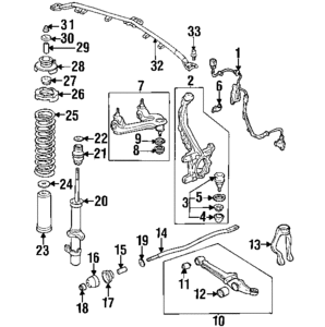

For anyone doing this in the future, is the bolt that goes through #13 in the attached diagram.
