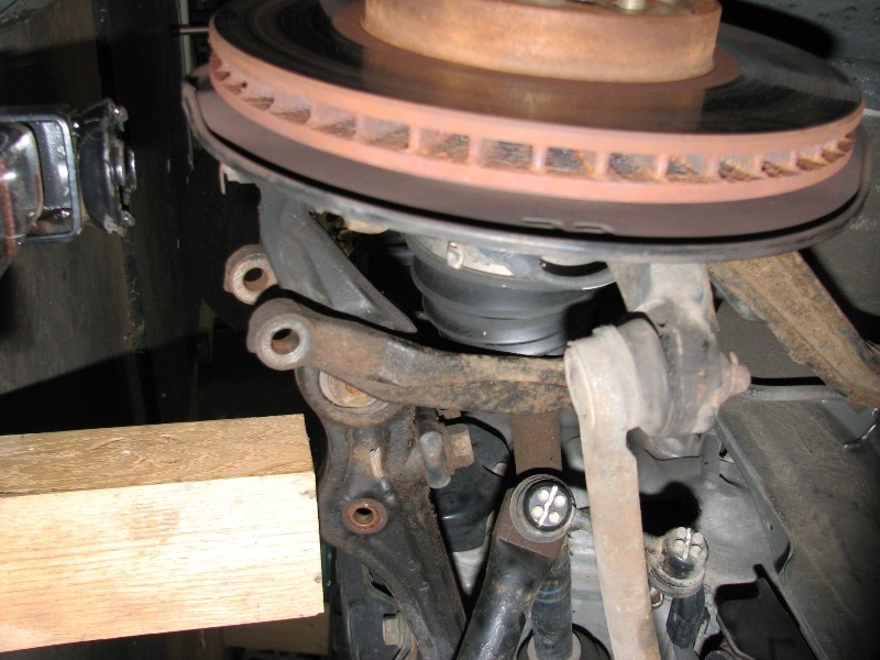

image 1:
image 2:
you will want air tools for this, impact tools are required to remove these lower bolts.
1. jack up car, support on stands, remove tire.
2. remove lower fork bolt (Image 1: 24 and 26)- 17mm
3. remove upper fork bolt (Image 1: 22) - 14mm at this point you can tap (down) on the fork to remove it from the damper, but it won't come all the way off yet...

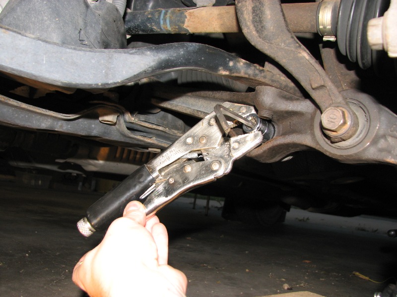

4. this is the tricky one - remove the lower link bolt (Image 1: 4/5, 21). the bolt on the link has a #5 Metric hex key end with a 14mm bolt. the bolt will spin freely. you have to use a vice grip on a 14mm socket and insert the hex key through the socket opening. hold the hex key still while you loosen the bolt. be patient.
Note: the reason you have to remove the link is so you can actually get the lower fork down past the end of the damper. use a jack to support the whole assembly as you lower the hub assembly.

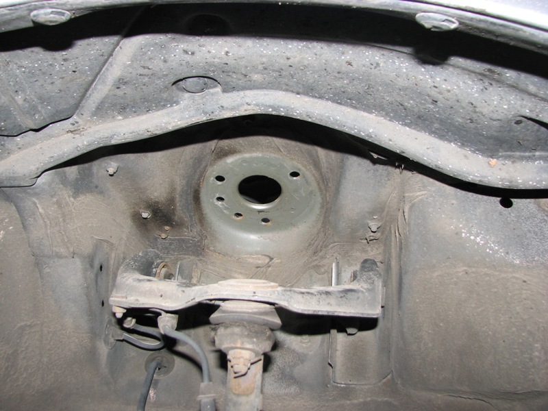

5. now you can remove the top 5 bolts holding the damper assembly in place - (3) 14mm and (2) 12mm. work strut out, you will need to raise the hub assembly to clear space.
6. most stores will rent you a spring compressor ($50) then you get a full refund upon returning it. mine required a 19mm impact to fully tighten.

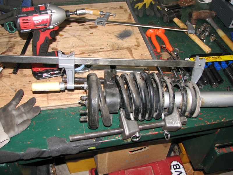

7. mark the position of the spring base (Image 2: #7) relative to the spring so you can properly align the base with the damper/fork. install and compress the spring. you want to grab as many coils as possible. once the spring is compressed and no longer putting pressure on the strut assembly, you can remove the top damper bolt. to do this, you need to clamp the top of the damper with vice grips or a crescent wrench while you loosen the 14mm bolt with a box end wrench.
8. on my struts, (Image 2) the #6 rubber are bad, and the #12 bump stop is bad. I ordered them from hondapartsdeals for $2 ea. and $7 ea, respectively. I replaced my dampers with KYB last year. We did not replace the bump stop (should have) and we installed the rubbers backwards (because they seemed to fit better that way). the rubbers started to shear from the washers. I had a rattling sound in the front struts.
follow the exploded diagram for part re-assembly after you get new dampers.
installation is opposite of removal.

I took some photos of the process.
remove the two 10mm brake line bolts

remove the 17mm lower fork bolt
loosen the 14mm upper fork bolt. tap fork off bottom of strut

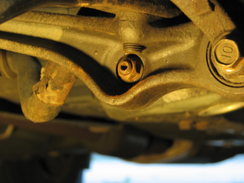

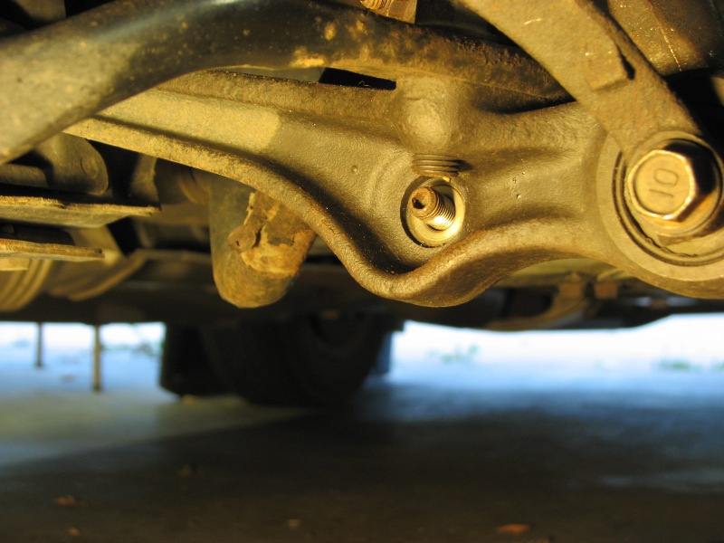

option 1: (hard) disconnect link to lower arm

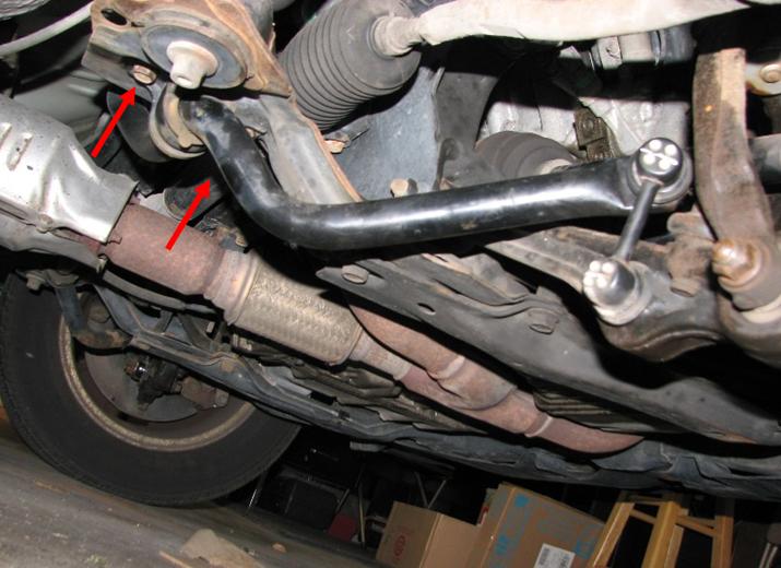

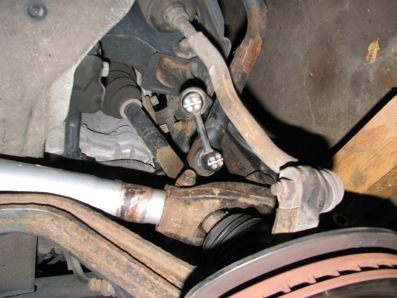

option 2 (easy) remove two 14mm bolts for sway bar (allows control arm to drop)
with the link or sway lowered the entire hub lowers enough to fully remove the fork from the strut/damper.
remove upper bolts (3) 14mm and (2) 12mm. remove strut

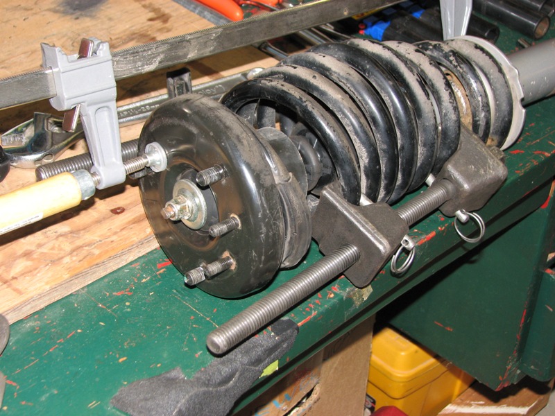

mark orientation of upper strut cap relative to spring (scratch a line on both)
compress spring (the additional clamp is used for reassembly only)

replace parts and reassemble according to the diagram. the rubber bushings must be inserted with the larger end on the strut cap and the smaller end against the washer. a clamp can be used to further compress the cap so you can get the nut started.
replace by working backwards.
