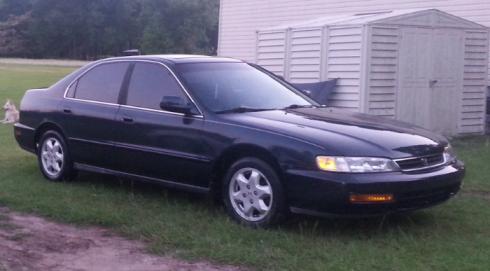

I want to lower it a couple inches. Stock ride height isnt attractive.

Cd5 Have you ever thought about going to a set of 4 coil-overs? They are adjustable from 0" to 4". ?
Old Jul 7, 2014 | 05:29 PM
Suspension is one thing I don't want to "cheap out on" - however a set of front OE springs from a four cyl will get you "some" drop just because of the weight.....however the unknown is the "rate" of those springs. Meaning at rest you wll have a drop, however as they travel, well things could go bad quickly.
The rear should not be an issue.
The 5th gen v6's are kind of an odd ball - not many around - so support for them is limited.
Old Jul 8, 2014 | 08:27 AM
I wouldn't put 4-cyl springs into a V-6 car. It'll drop a bit, but then they'll be too soft. You need higher spring rate to avoid bottoming the car all the time.
