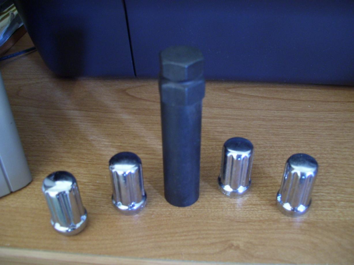

Well let's see here: 1stthings...your Honda takes a 5x114.3 mm wheel bolt pattern, you'll have to measure that Konigs bolt pattern. Your Honda Cpe offset of between 42-55mm so you have to measure the ET or backspacing..I will show pictures at the end..if the konigs are 18" ? your tir size can be 225/40/18's, lugs ...Yes aftermarket and they would be 12x1.5mm nut lugs - better know as tuner lugs..wheel spacers ..NO!..not really safe unless you have them made special.
Hope this helps you beter with your larger wheel Quest..

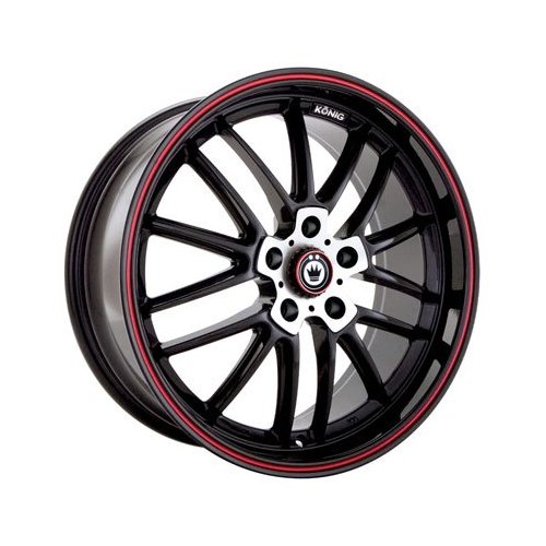

Ang,
I found out the Wheel will fit perfect.... Thank you...
I attached a pic of the exact wheel I have
I will get the Tunger lugs.. 12x1.5
Still pricing power coating.. I may have them painted.. Anyone in Florida know any inexpensive powder coating places?
I still have questions about the tire size.. I am illiterate when it comes to tires.. you are suggesting a wider lower profile tire??
Again I am unsure about tire size.. I am looking for something will give me a smooth QUIET ride.. Maybe this has to do more with the actual brand of tire? I would assume the tire size has an effect also?
