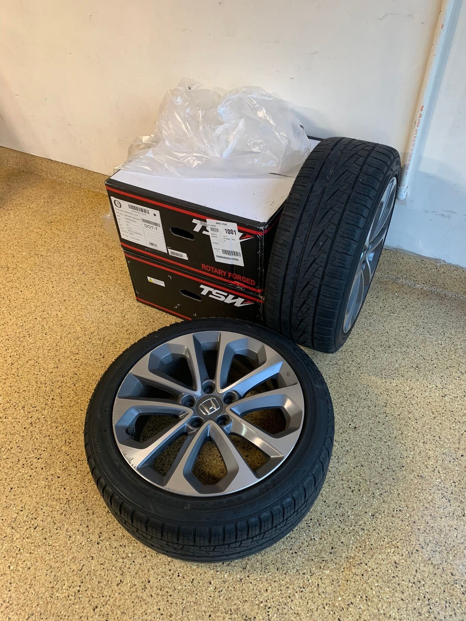

I have a 2015 Accord EX-L V6 Coupe and last year I got new rims. I would like to give them to my sister-in-law who has a 2007 Civic EX Coupe. Last year we also moved from PA to TX so I would be mailing these up to her in PA so I obviously don’t want to ship them to her if they won’t fit. They are the stock rims that came on the car - 18x8. There is another thread I found where the reverse was attempted but due to the smaller rims from the civic the breaks on the Accord were a problem. I don’t see the breaks being a problem since the Civic is smaller than the Accord. My concern is the bolt pattern. So in the above thread the bolt pattern was fine so I am thinking we will be fine as well? But those were both 2 different models than we have. The rims I purchased: TSW NURBURGRING GUNMETAL 5X114 19X8 +35 1980NUR355114G76 64.1
If my bolt pattern is 5x114 and I believe her Civic is also 5x114 I think we will be fine I just wanted to get some input before needlessly shipping them. The attached rims are the stock rims. 2 have no tires and are in the TSW boxes.

The wheels themselves should mount up with no issues, however, unless she changes the tires, the ones from your Accord are too tall for the Civic and will cause significant speedometer error (the Civic's speedometer and odometer will both register low).
