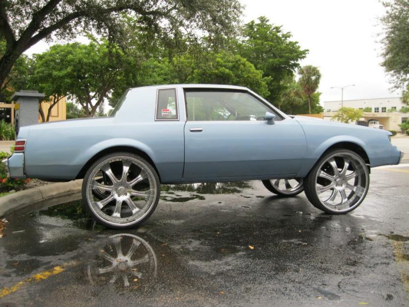

Wanna Be! bigger.? go to the 235/45/18" combo....
WheelbrokerAng
Attached Thumbnails 225/55r17-310939_184429544968132_102934226450998_391768_212547926_n.jpg
