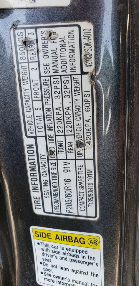

205/60/R16 are the sizes recommended for a TL acura. I never thought about load rating. Are 16" wheels common on a lot of honda mfg. I would think they are and some even bigger. As far as the lugs I figured they would be different than anything going on a steel wheel. I've mostly dealt with American cars.
But if they work and fit correctly I'll use them or just get new ones. I was going to buy new tires at Costco but they will not warranty them since the car calls for a 15" rim. Picture is from 03 Acura TL I saw at local bone yard

I know how tire stores can be, but if you had a 2003 Accord EX (about the same weight car) it would come with 16" aluminum wheels and it would have a sticker in the door jamb with the 16" tire size. Actually, if you have the owners manual it should come with a table showing the different tire sizes for DX, LX, EX, etc.

Thanks Jim And Shipo I really appreciate your help. Yes I see these rims are actually on the EX model. Maybe if I just tell them it's a EX they will honor the warranty. The badges are missing anyway. Unless they put the vin in and it tells them. Either way I will have them on the car regardless of warranty. Thanks again guys

Check out what TireRack can do. On one hand they have local "installer" shops that you might talk to (they have customer-ratings for these shops). Or, you can shop tires on line and have a print-out showing 2003 Accord EX with 205/60 R16 tires.
