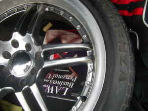

hi guys i just got rims from friend
i have 97 honda accord v6
the rims is kg 690
i try my lug nut it didnt fit so i went to autoshop with no help from anyone there of course there was no one to ask for help.......i got lugs size 20*1.5 i try to install it but i guess it was short and not fit well inside the rims
so what size i should get and how long.........any help plz

You need to get "tuner lugs" with a 12mmx1.5mm thread, also must have a tapered seat. Gorilla makes a reasonable set of tuner locking lugs, expect to pay about $40. Head to a tire/wheel shop to get some lugs.

thx bro i got ur advice and it work fine
