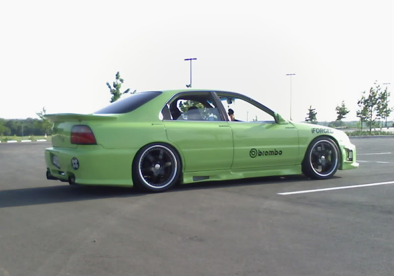

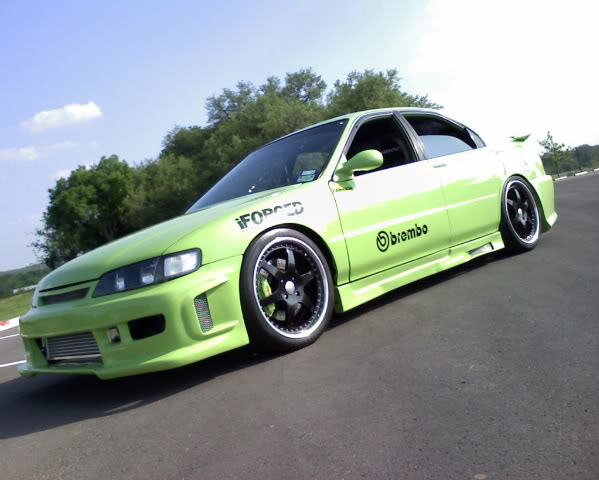

Yeah.
I'm dropped 1.5F/1.3R
H&R Springs
KYB Shocks

Nice ride Blackknight07644, good setup with the bodykit and wheels

that is a sick ride blackknight, that's the same accord I have, yours looks awesome, what all did you do to it, how much did it cost??
