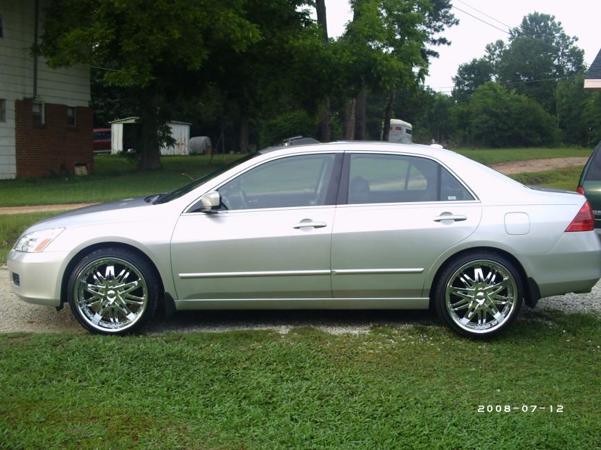

I was wondering what you guys think about me getting Halo Lights on my 2007 Honda Accord.

I think they would go great with some 22" chrome wheels and a large rear wing, add on some fake air vents on the front fenders, chrome pillar covers, blacked out taillights.
If that is the look you are going for then...
In all seriousness, depends.
There are 2 ways to get the Halo rings for your headlights
1) buy the cheap headlights that have them already installed. These are bad for a few reasons. First is the quality of the projector (that is what focuses your light) is so bad that so much less light is on the road. The factory headlights do 10x a better job at lighting up the road. Second most aftermarket lights tend to start leaking at sometime, getting the moisture in the lense which looks like poo and makes it even harder to see at night.
2) the other way involves splitting open your factory headlights and installing a halo ring around your factory projector. This method lets you keep the high quality factory housing and will work much better.
If you are planning on doing it the 2nd way and the Halo look is one you like then go for it.
There are tons of write-ups on both this board and many others on how to do it.
Good luck to you and remember do not buy crappy aftermarket headlights cause they really really suck.
