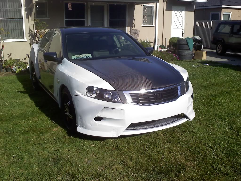

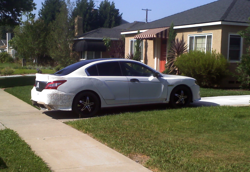

here are some pics from today

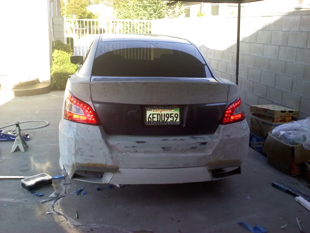

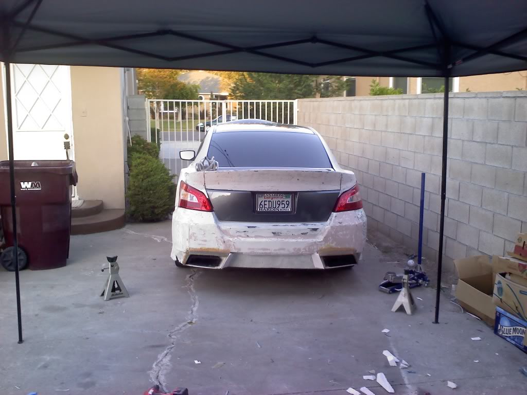

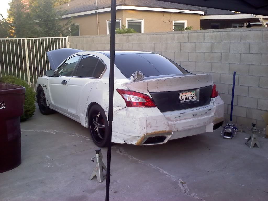

well i have to knew ideas for the rear.
the first one i think makes the car look a little DUB and im not going for that look
the previous bumper i thought looked rice and im trying to go for a more stock looking car is this still rice?

Damn DUDE crazy skillz you got there. LOL if i was you i would of been going crazy with all these changing around i give you props for that cuz i think i might of been like **** what have i done lol..but good job man. Love all the looks and ideas you getting.. in my point of view with that "spoiler" you made now i think makes the back look a little BULKY with a 750 bmw look ..the front fender is sick as **** lol..and i love what you did with the headlights. This might be a stupid question but how do you figure to open the back passager doors without the handle? lol =X and i love that muffler cut out you did thats hot to man...but anyways you got skillz and like everyone stated here cant wait for the finish product keep up the good work kid

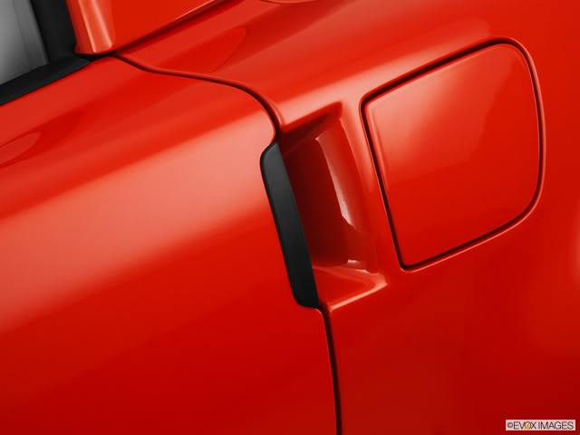

yeah still go crazy trying to design something i like that will also not look stupid on the street. anyways thanks for the comments. the headlight was a lot of work i still have to do the other left side lol. the rear i know looks a little bulky but theres not much i can do at this point about it but im still checking all my options. as for the rear door im going with something similar to the way chevy made the corvette door handles (2009up) heres a pic of one.

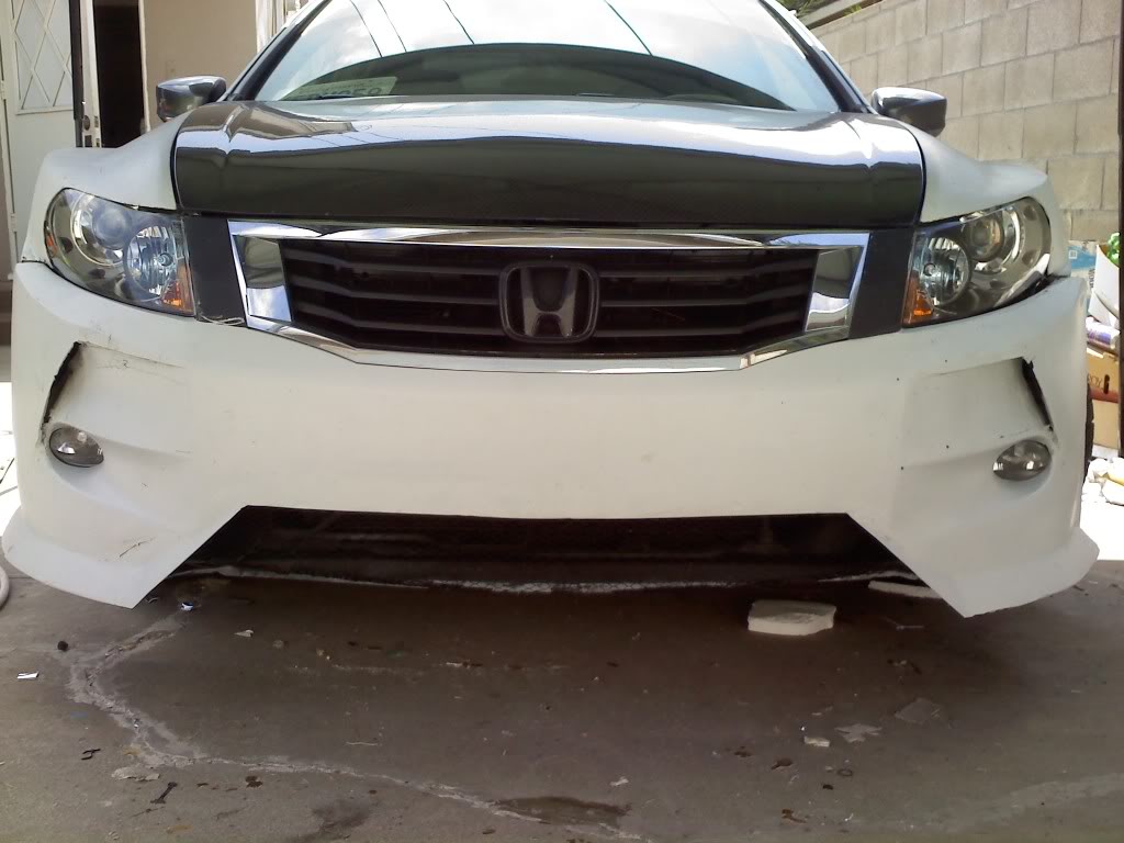

by the way im not sure if you guys were able to notice but
can anyone guess what car my projector headlights are off of???

Oooo got cha ....looks like a big project there itself with the door handle...and the front lights I believe looks like the chevy camero..if I'm Wong place correct lol but sill looks hot
Old Jun 8, 2012 | 04:02 PM
  #147
Joey6458's Avatar
Joined: Jun 2011
Posts: 177
Not really there's a botton inside and a solenoid to unlatch the door the front door will almost be the same. Difference is the botton will be under the side mirrors. I would have used camaro lights. I just didn't want to spend the $700 each for them so I had to go with the challeger lights $130 each plus I think these look better than if I were to have gone with camaro.

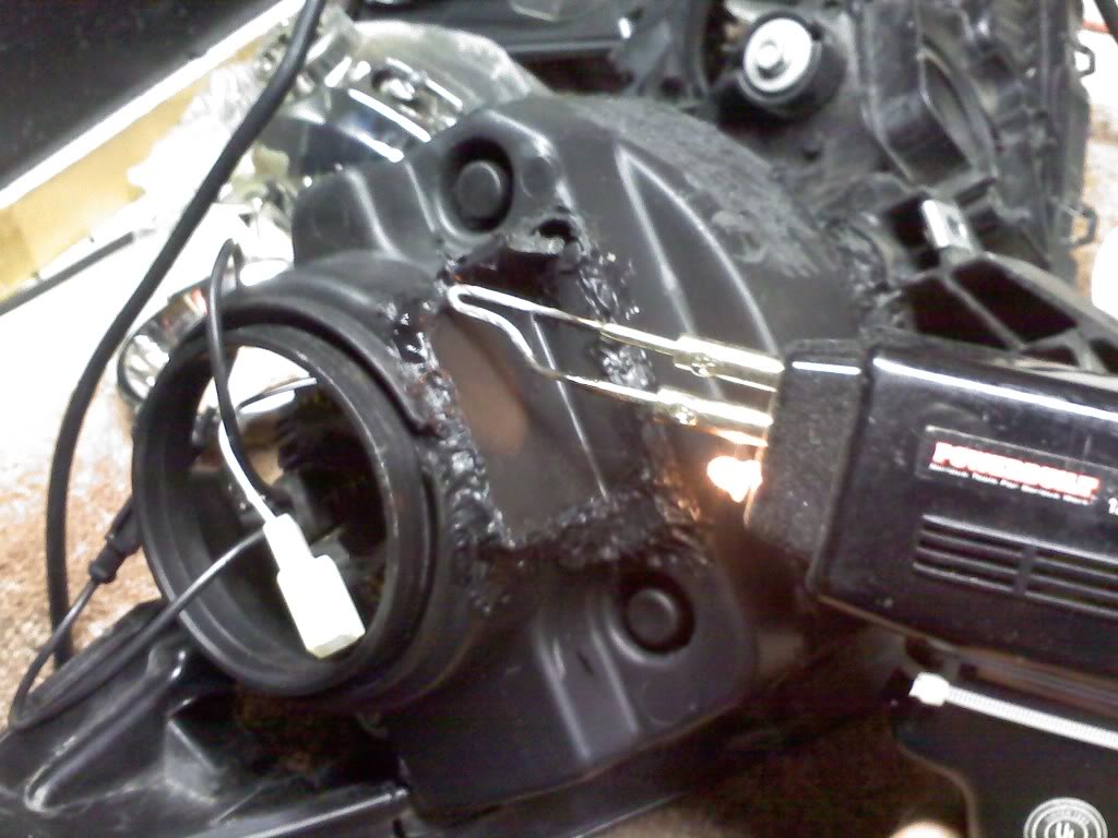

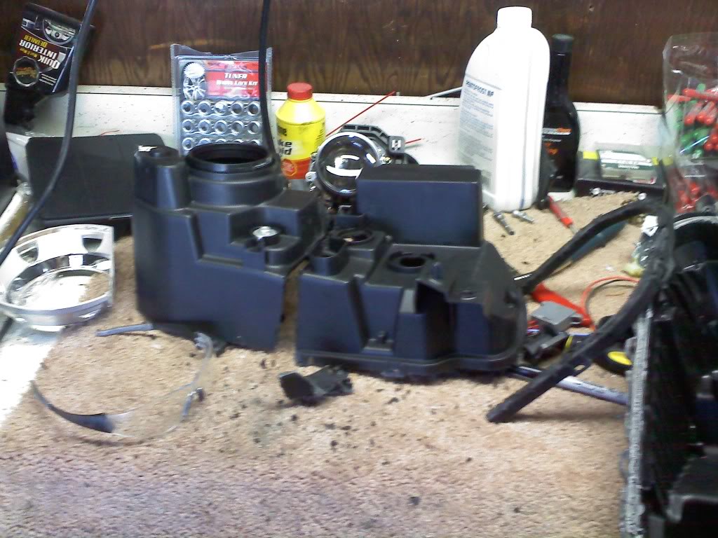

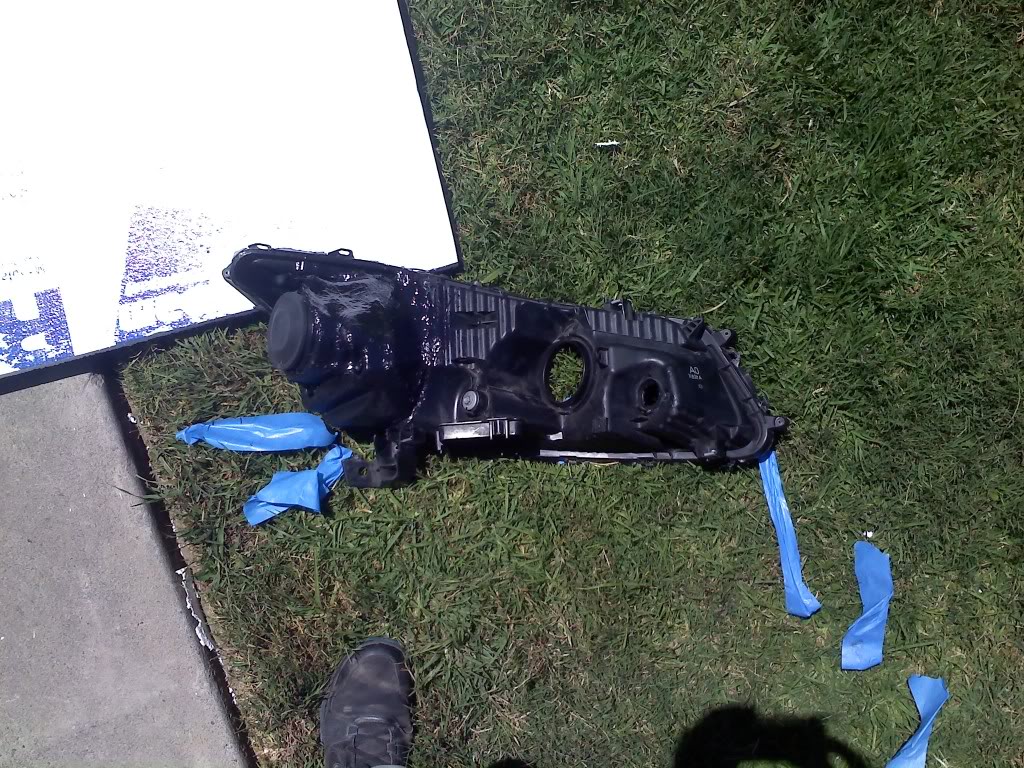

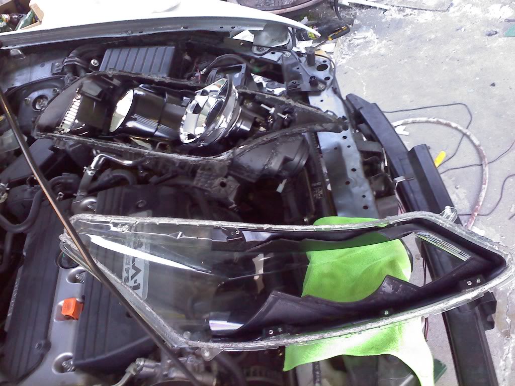

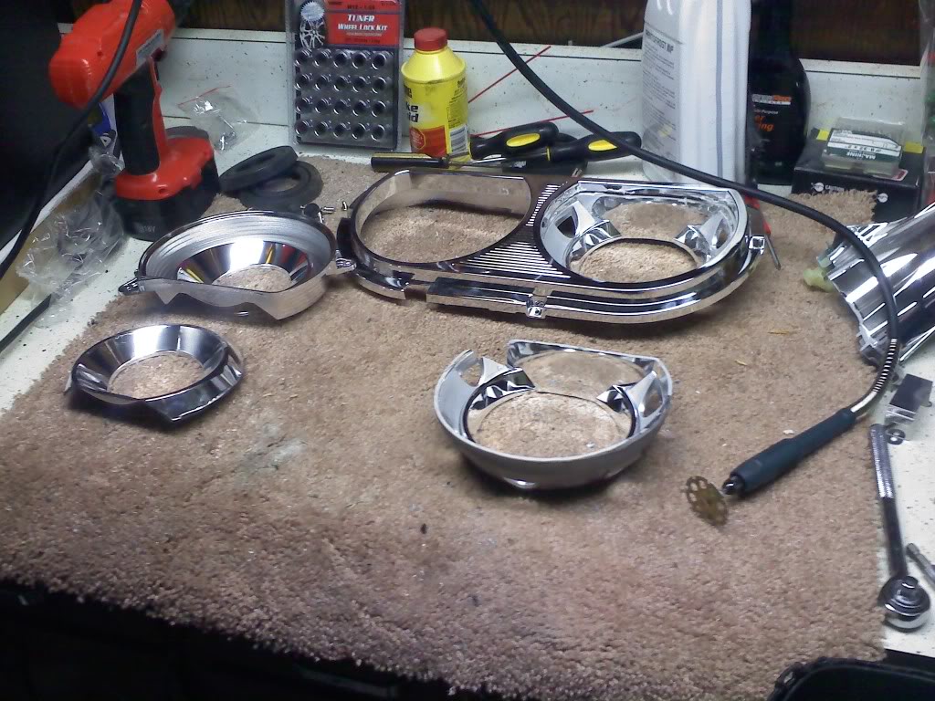

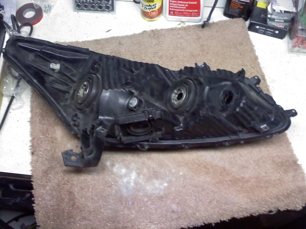

here is the build on my retro projector lights
here the back of my assembly stock

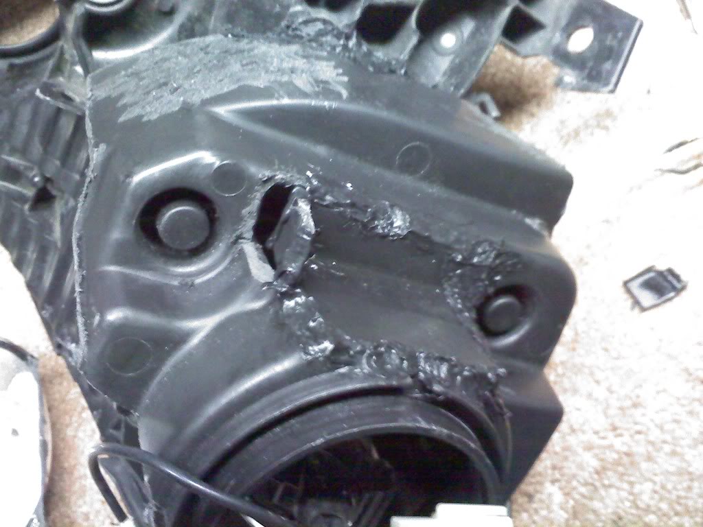

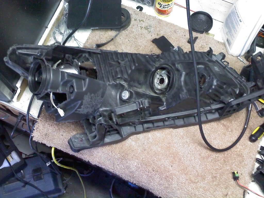

i have to cut much of the inside out including the head light, the side marker, and the back of the light assembly

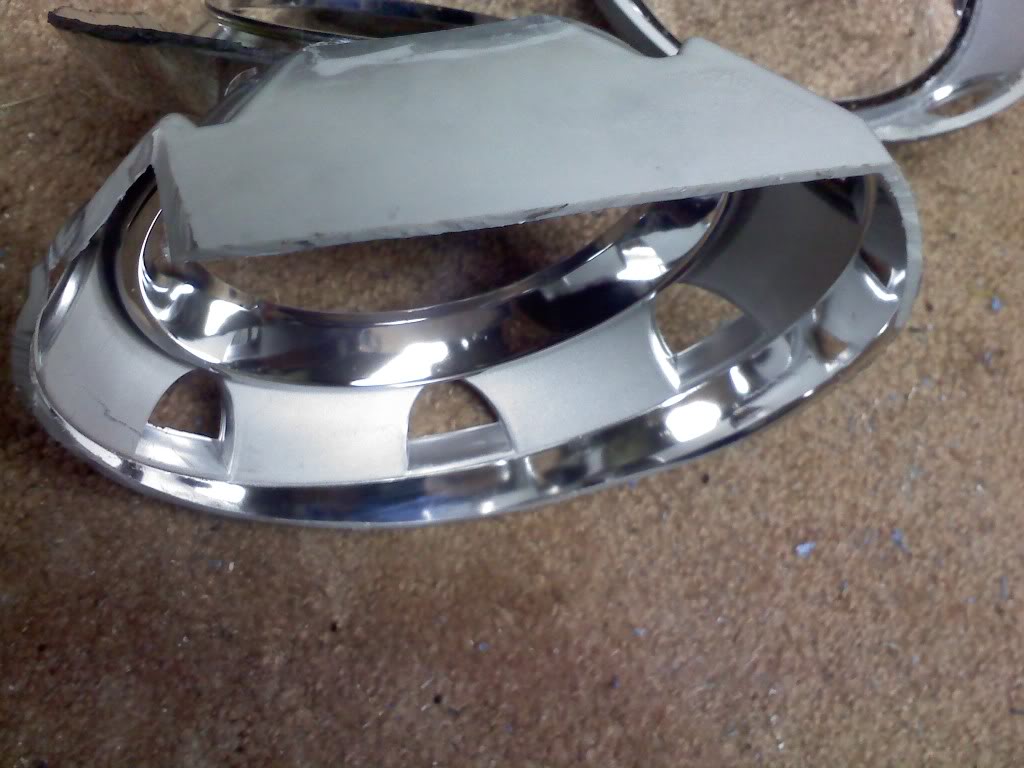

the challenger light get the same treatment

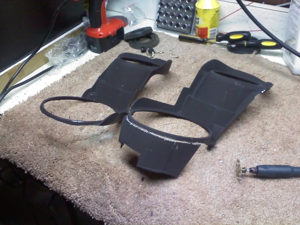

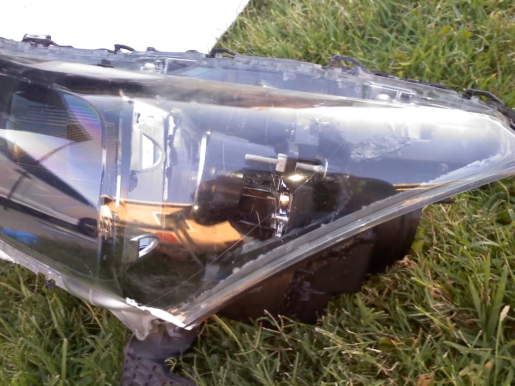

after everything is cut i then attach both housings together by melting the edges of the plastic.

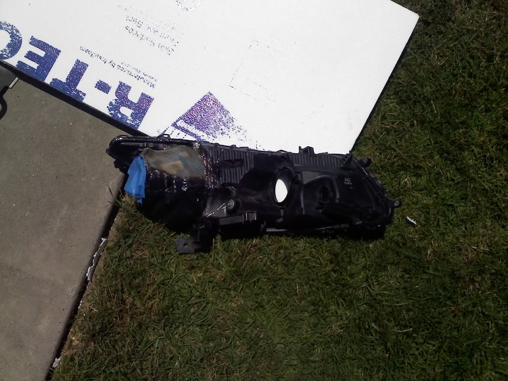

I then fiberglass the last hole shut.
Removing the side marker exposes the projector but my fender covers it

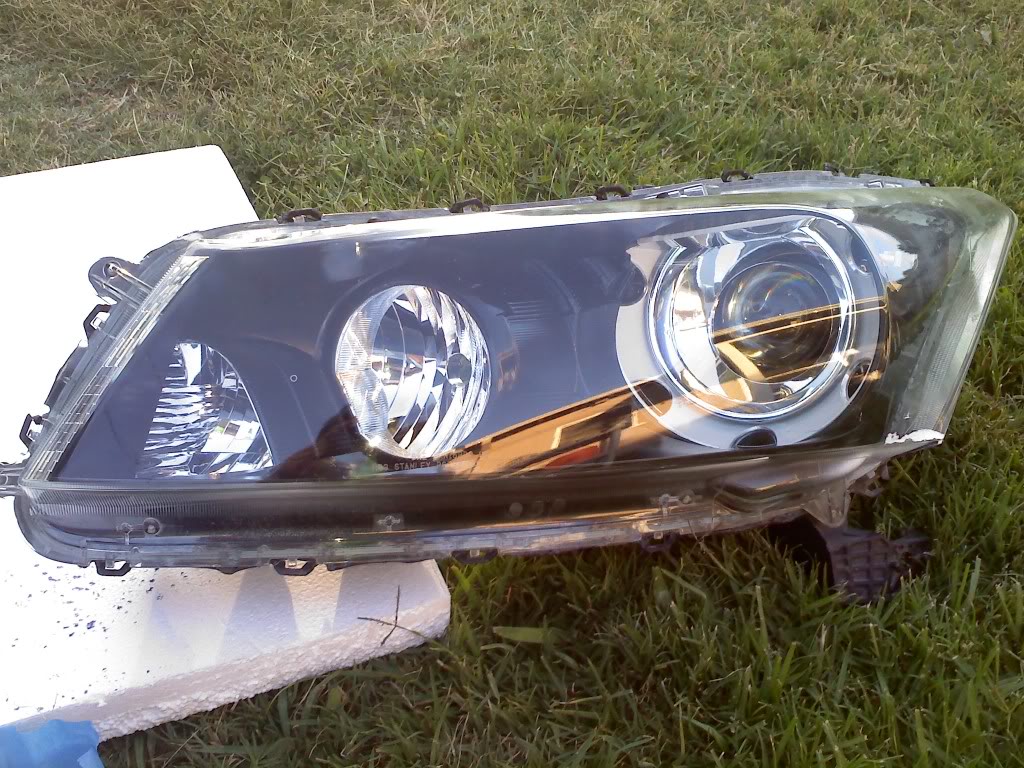

The finished product
