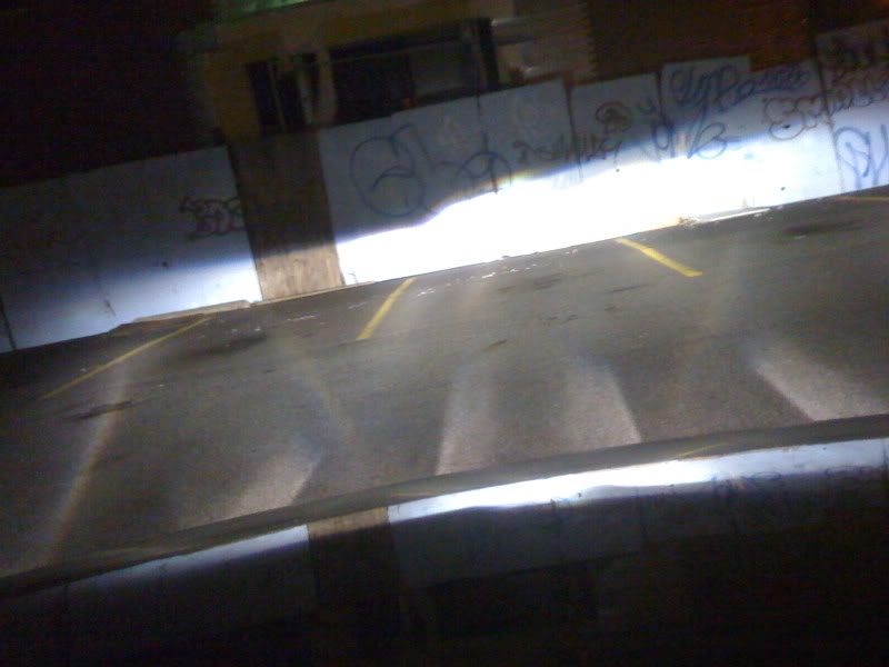

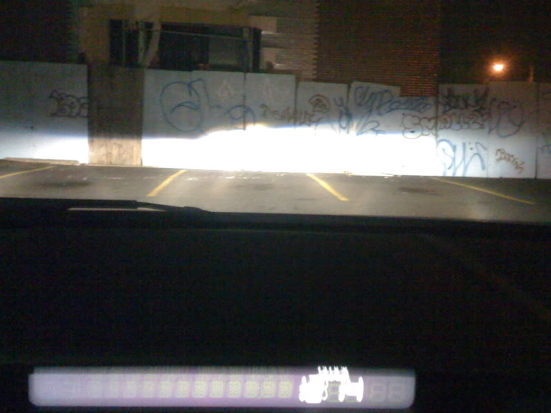

Cutoff 1:
http://s47.photobucket.com/albums/f1...Picture003.jpg
Cutoff 2:
http://s47.photobucket.com/albums/f1...Picture004.jpg
Cutoff 3:
http://s47.photobucket.com/albums/f1...Picture017.jpg
sorry about the graffiti. What do you guys think?

It's very poor compared to OEM projectors, but about the best you can do for the money. Proper projector aiming the cutoff should be 2" below the centerline of the projector at like 25' away. Looks like yours is a bit too high.
At least the driver side is nice and level, that's the most important so you don't blind people too much.

which cutoff line exactly lol?
as you can tell they both (left and right) flare up a bit to the right.
is there anything i can do to fix the flaring on the right?

You would have to open them up and rotate the projectors.
Both cutoffs should be 2" below the centerline of the projectors. Measure the height of the projector lens at the car, park the car 25" from a wall and shine the lights on it. Subtract 2" from your measurement and that's where the projector cutoff should hit.

thanks when i find some time and its not snowing i'll give this a shot, its hard to find a completely flat, clean, completely dark wall in my area
