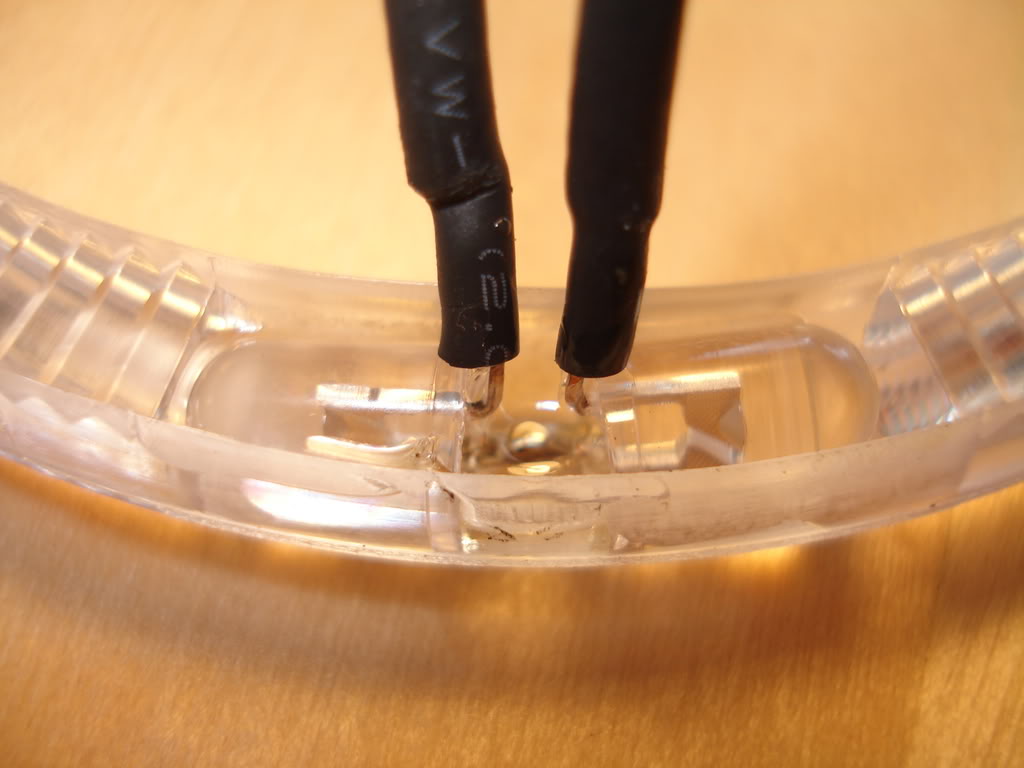

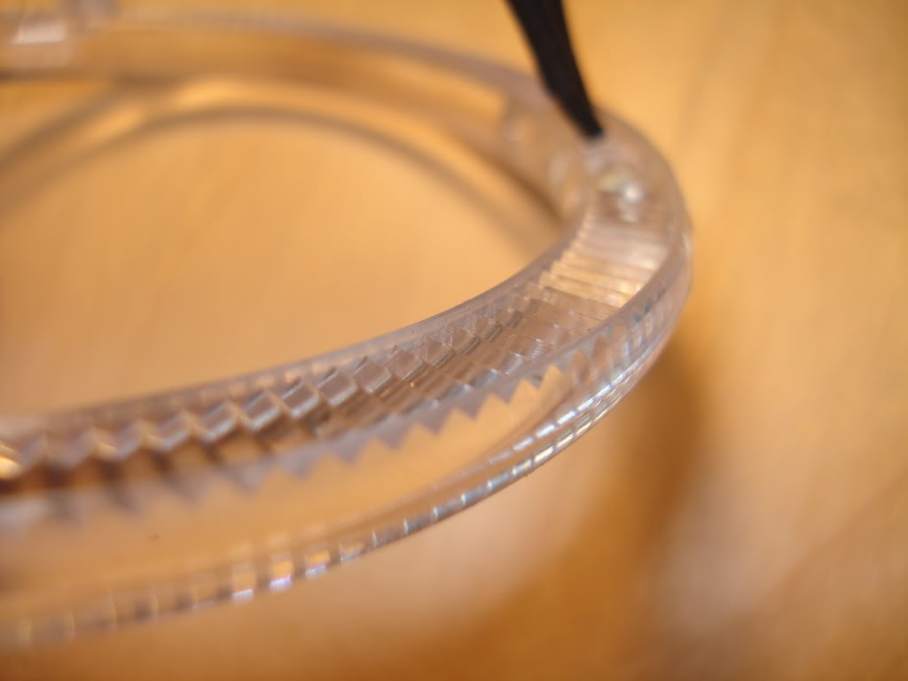

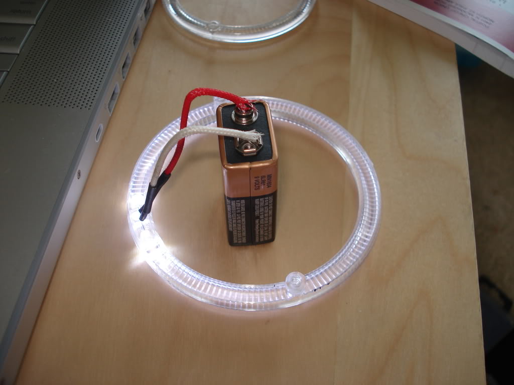

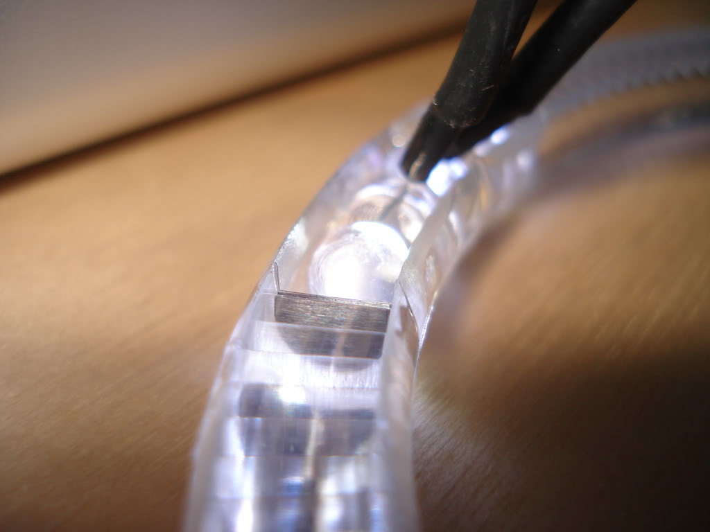

http://superbrightleds.com/leds.htm, look at the 5mm 18,000 mcd white one (like 10 down). It gets it brightness from the narrow 15º viewing angle, which should be fine because the halos work by 2 LEDs shooting light down the center of the halo and the light refracts off of the angles molded on the back of them. Let me get a picture quick.
