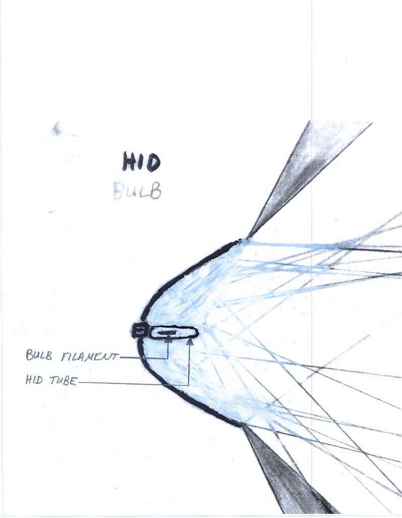

The sketch below illustrates the "sweet spot" discussion. As indicated, the HID tube covers and emits light from all points that the bulb filament will hit. This is what I meant by the second sentance of the first paragraph.

The remark about the validity of the second link is in referance to the paragraph below ..... the entire paragraph that the note that you posted came from:

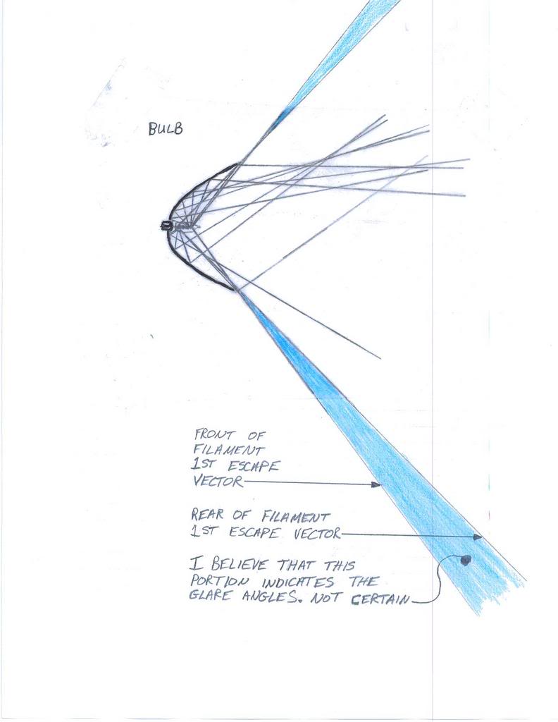

Below are vector analysis sketches. The reflector shape that I used is intentionally deep to create a larger variance between the types of beams for discussion purposes.
Here is the base sketch or control if you will .... the bulb.

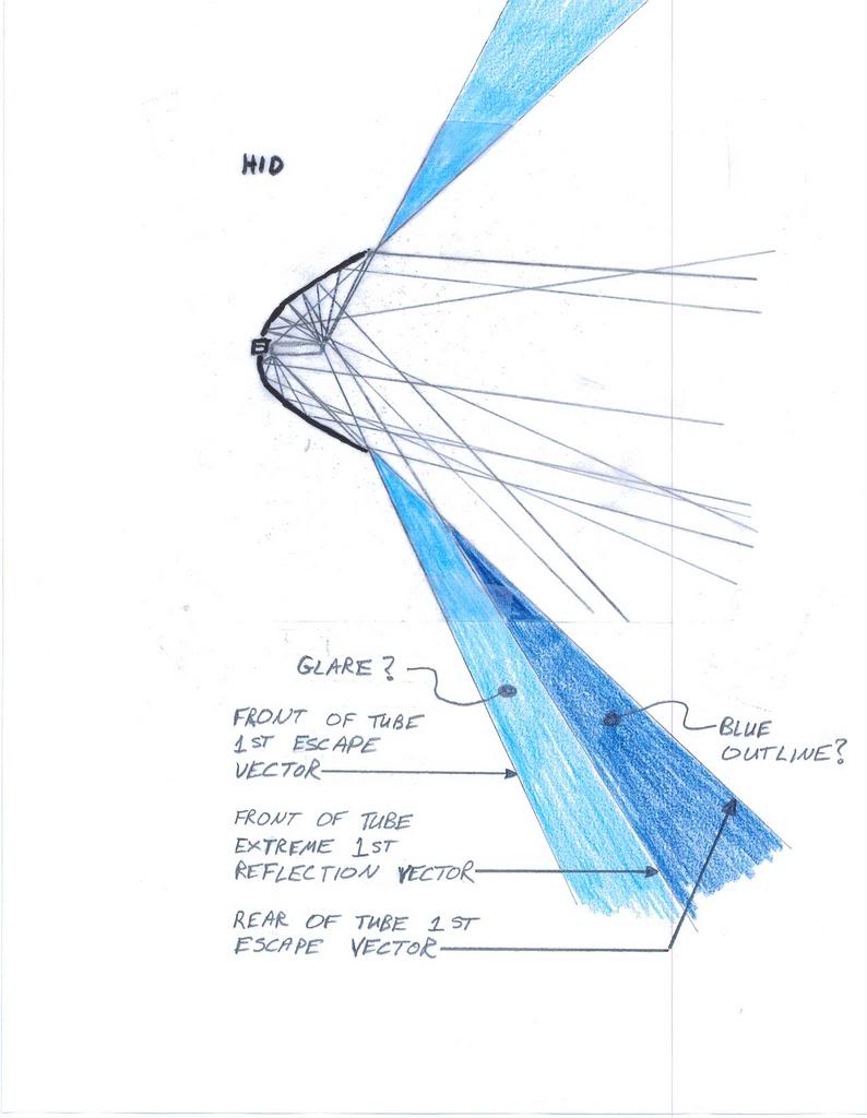

Next is the HID tube placed in the same reflector (exact same reflector used, bulbs and vectors are on tracing paper).
You can see that the direct glare spread here is much larger, but the inner portion is confined by the first reflection vectors. The resulting glare is at a wider angle, but similar in total amount of glare. I believe that this illustrates your point.

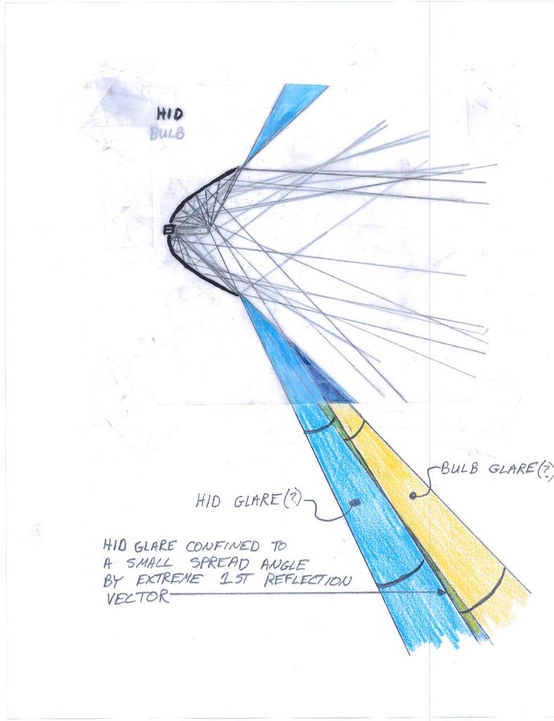

Here's the interesting one .... the overlay:
This illustrates something that hasn't been mentioned. From a distance, the bulb will produce a larger glare halo due to the larger resultant glare spread! The other point here is to show that the differances in glare angles, while not insignificant are also not huge. As noted above, this does not account for refraction since that is frequency dependant. I'm only interested in the fixture vs. bulb effects (no need for proof why I'm discluding active HID fixtures also).
