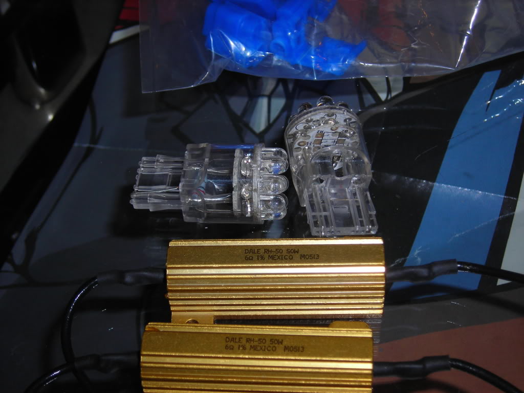

As far as the whole wattage thing goes, I think it is based more on load/amps than wattage itself and if you wire them in series or parallel. When I made my own footwell lighting and underlighting I used PVC piping, that I cut in half vertically and drilled holes to mount them.
I bought these and used them for like 5 minutes a couple years ago. The gold resistors are made to withstand a large load on vehicles so they wont melt. The led bulbs have 15 amber leds and by themselves they would blink super fast without the resistors b/c they didnt put anywhere near the load required to tell the car that the bulb works. It would take way more LED's than you plan on using to put that much of a load on it.
Sort of... if you read my calculations, each group of leds would pull the same amount of power as a bulb.
i.e. the 5W draw of the tail lights on = 21 leds that pull 20mA each
12w draw of the brakes on = 50 leds that pull 20mA each
That's 17W being pulled when the brakes are applied and 3 banks of leds lighting up, 71 leds total on each side pulling 1.42A @ 12V, but I need to acutally get in there with a multimeter to get an actual voltage reading, since my car operates @ 14.5V running. If that's the case I'll need leds that draw ~17mA ea or just use less 20mA leds
