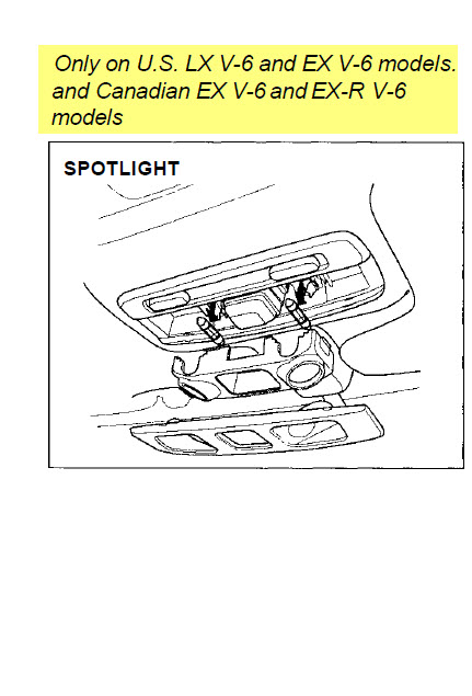

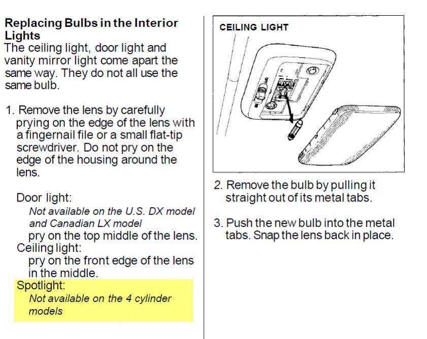

On the Sylvania bulb guide site, it list DE3022 for the maplights and DE3022 or DE3175 for the dome light.
On the 1994 Accords, only the V6 had both the maplights/spotlights and dome light. The 1994 Accord 4 cylinders only had had the dome light.
See attached pics.
Attached Thumbnails Looking to get LED Dome/Map light.-1994-1995-accord-interior-light.jpg   Looking to get LED Dome/Map light.-1994-1995-accord-spotlight-v6-only.jpg

Oh alright. So they use the same bulb then. Thanks!
