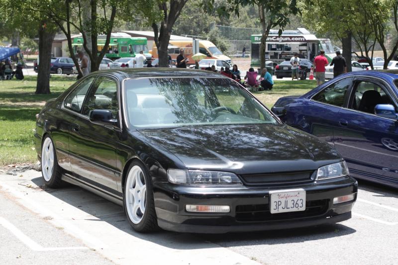

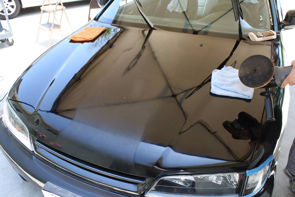

Since I had a big meet coming up (Cali Accord Meet, largest Accord meet in the country), I then focused on getting the car looking presentable. First was a full detail job to try and restore my now fading single stage paint. You can see the faded paint in the middle, and the detailed sections on the side.
I decided to plasti-dip my wheels white, to cover the blemishes, plus I'm a sucker for white on black (my dream wheels are Regamaster Evos). The actually came out better than expected.
I also ditched my OEM grill for an authentic one......picked up a Plus1 mesh grill.
All ready for the meet.

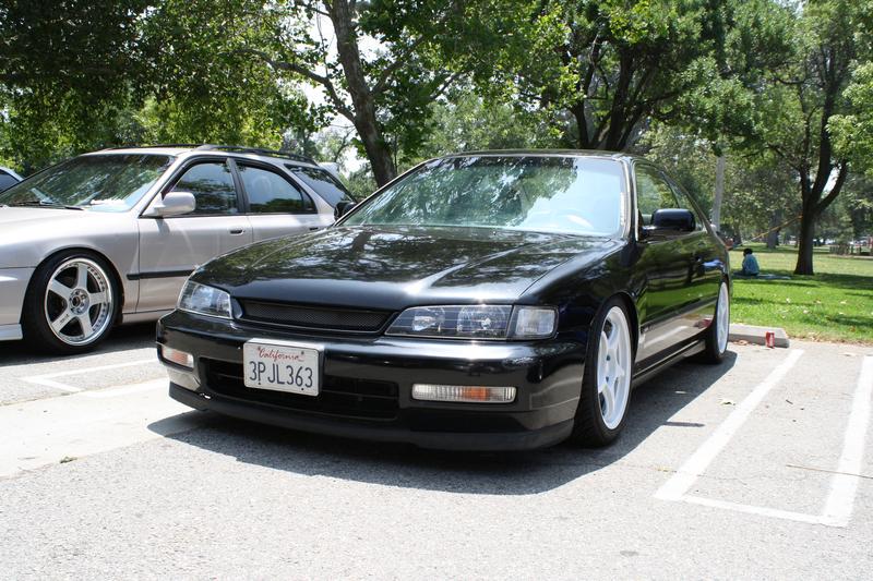

I think its Fiji blue.....not 100% sure though. Here's a full shot:

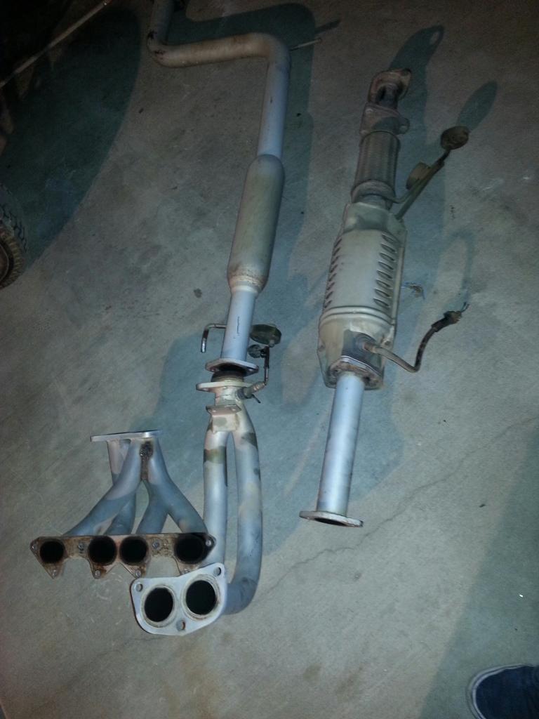

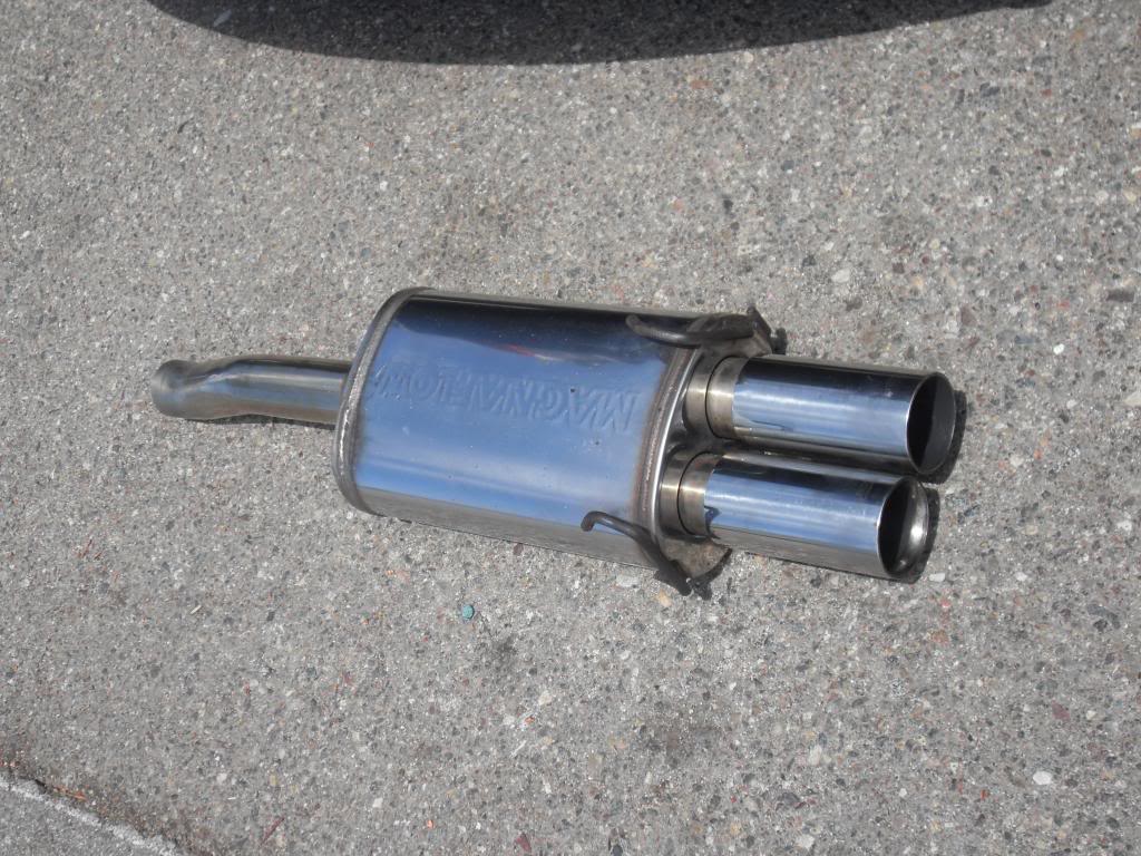

Little update for you guys......been collecting some parts.
Magnaflow dual tip muffler
DC Sports header (CARB legal)
Within the next couple weeks, I'll be piecing together the rest of the exhaust system......new OEM gaskets for the header, 2.5" mandrel bent piping, Magnaflow 18" resonator.

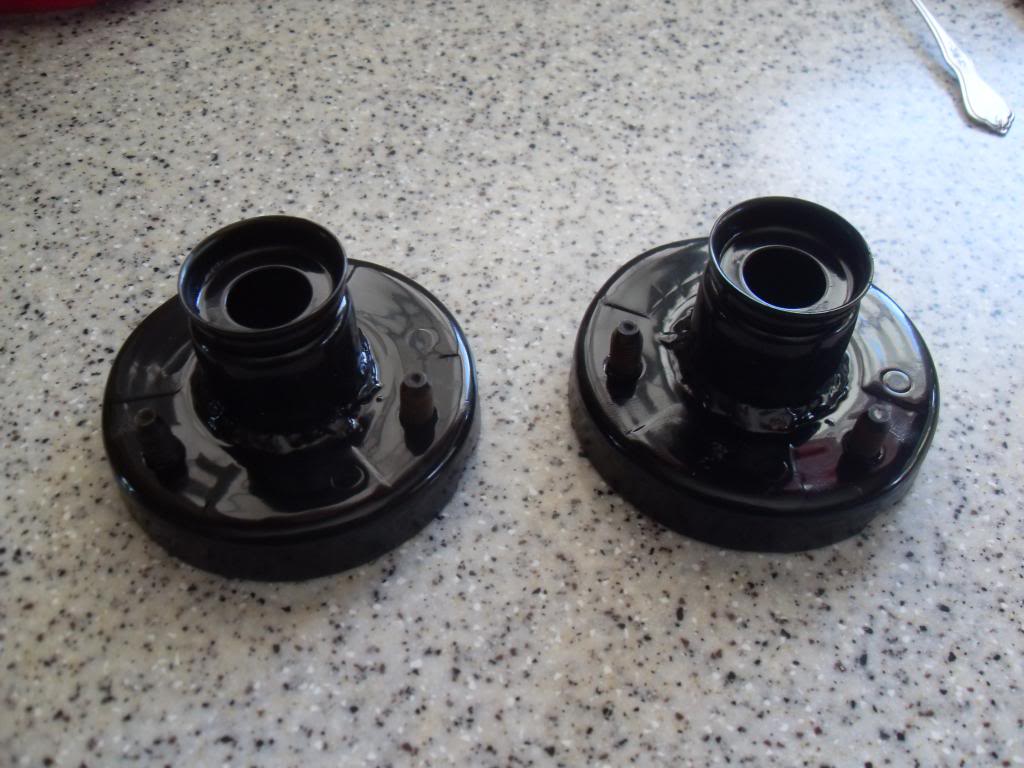

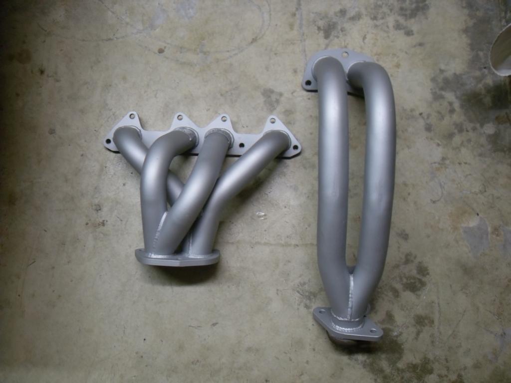

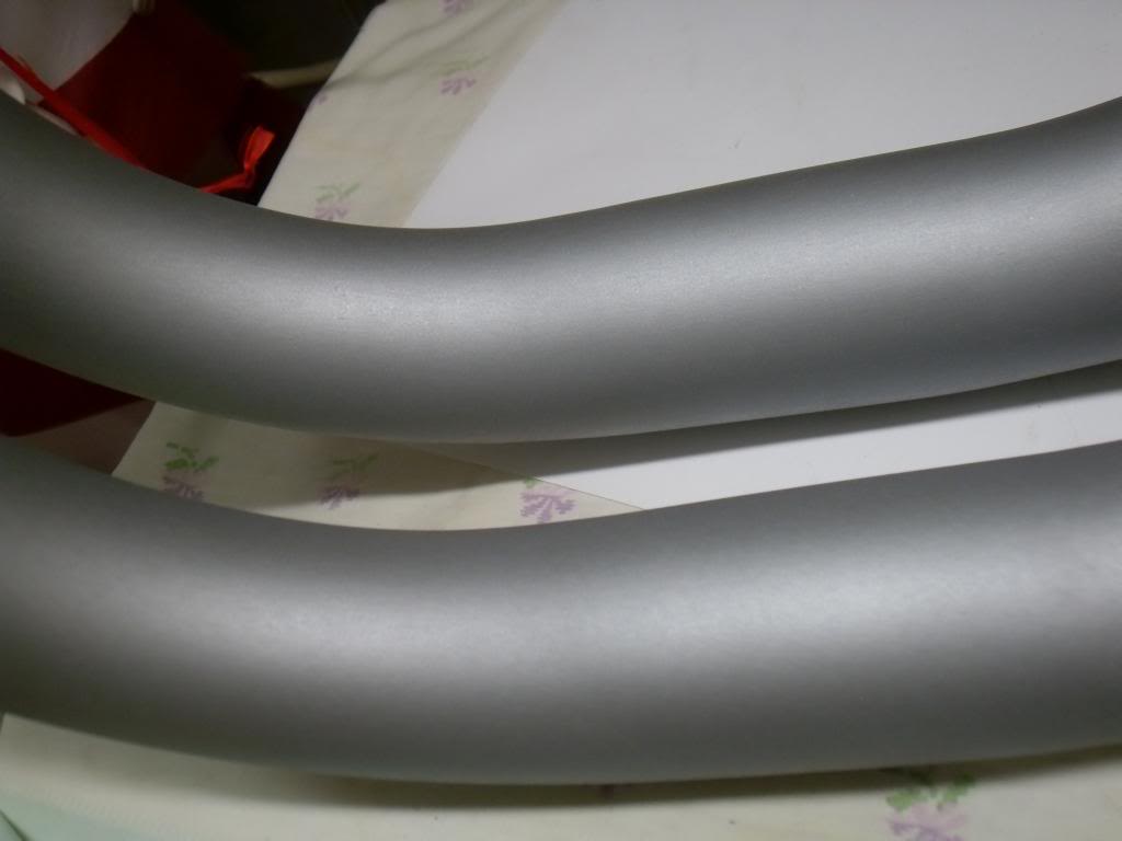

I first decided to refinish my DC header. As most people know, they have a problem cracking at the primaries. This one was no different. Previous owner had repaired it though, but it was ugly. Also the header was just all around beat up with scratches. Decided I didn't want it looking like that on my car. Sanded down the header with 600 grit sandpaper. Then sprayed it with high heat primer and VHT flat silver ceramic header paint. Pretty happy with how it turned out, looks brand new minus the deep scratches.
Before:
After:

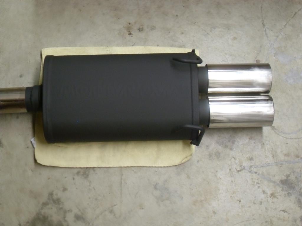

For my Magnaflow muffler, it had a little bit of rust and some scratches, so I figured I might as well paint it as well. Plus I wanted the muffler to look more low key (no shiny stainless steel flashing in the light) and stock-like, minus the larger dual tips. I again used high heat primer and this time along with high heat flat black paint. Just need to polish the tips a bit.
Before:
After:

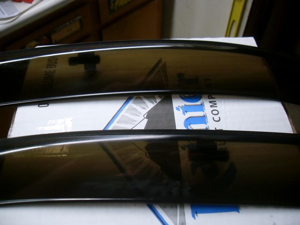

I also repaired and restored my JDM window visors. A couple of the clips had broken off, so they were re-attached. From years in the sun the outer finish of the visors had become dull, so I had them polished back to their original finish.

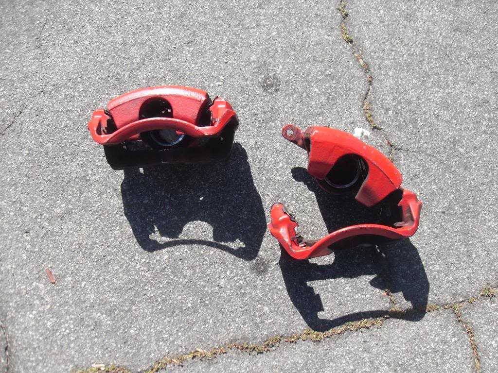

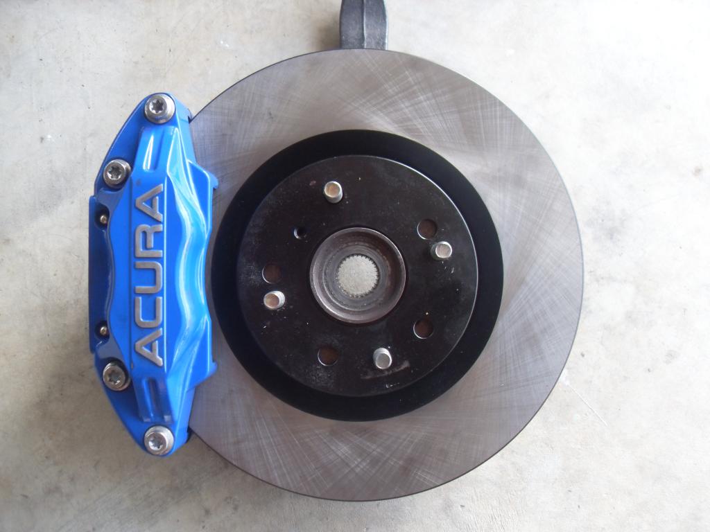

And lastly, I did some thinking, and since I was planning on upgrading the brakes, I figured why settle for just a single piston caliper upgrade? Why not go bigger.....say a 4-piston caliper?
They are OEM Advics calipers off an '05+ Acura RL. I bought them from a friend of mine, along with the brackets to mount them to my car. The calipers were fully stripped and rebuilt, along with the blue powdercoat finish. And I already confirmed my wheels will fit with no clearance issues.
Be on the lookout for another update in Dec/Jan, when most of these parts will go on the car.

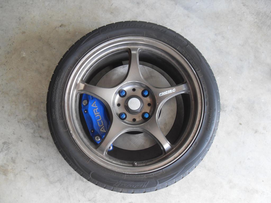

Finally got my rotors back from getting re-drilled.....did a quick mock up just to verify that everything would go together with no issues. Will be getting installed next Friday or Saturday.
