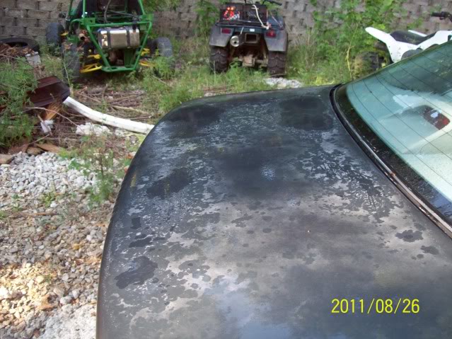

Anyway my car had the classic clear coat pealing off like many Hondas of my age.

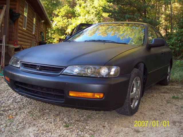

Last year I lightly sanded it and painted it with some flat black paint.
It looks ok sometimes (different angles)
Anyway I wanted to improve it so I bought my own gun and practiced on a few panels, atvs, wood, ect...

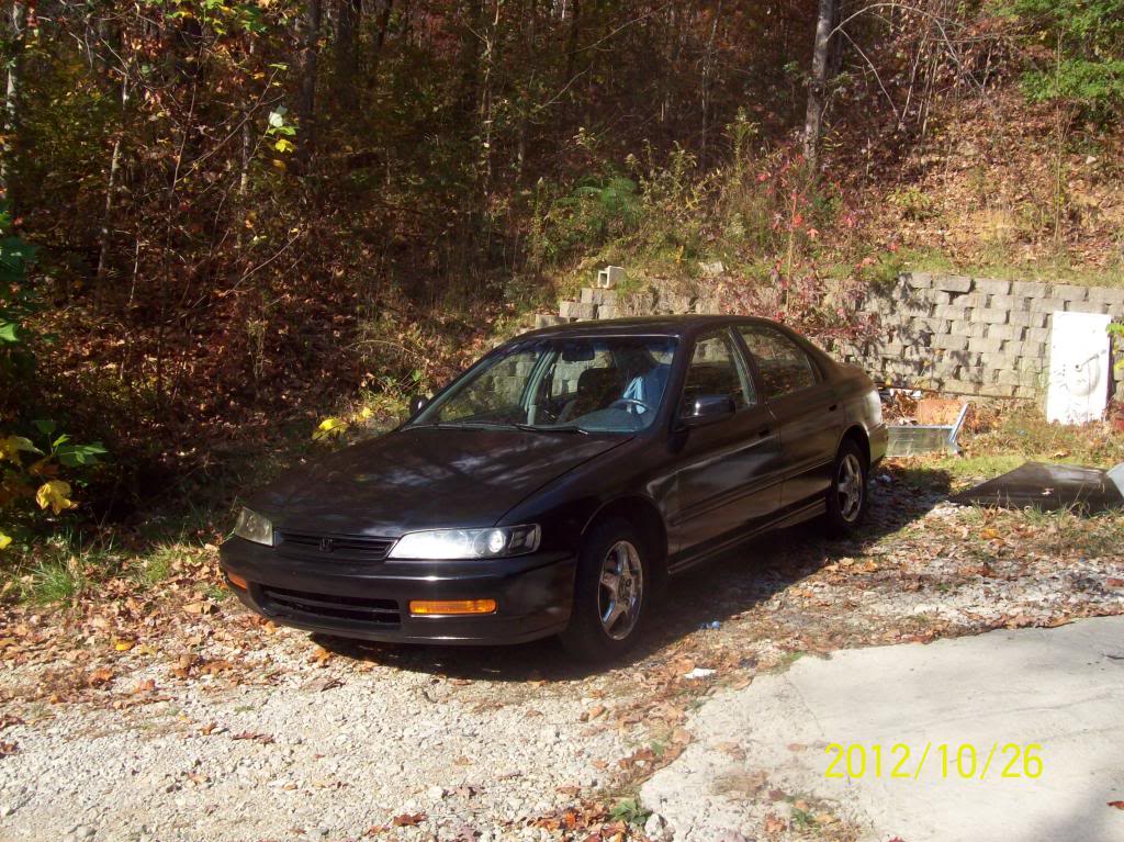

I started to get decent so I resanded my car and sprayed it again. This time I mixed 50/50 Gloss Black and Satin Black. it turned out pretty good.
Before...

Last year's paint job

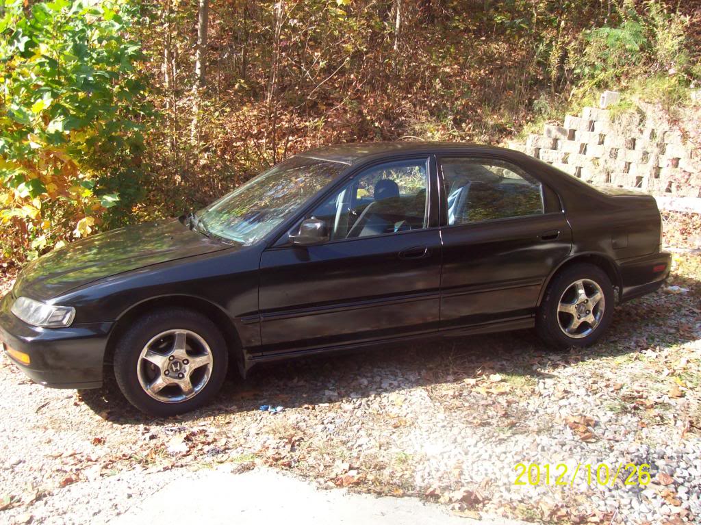

Current Paint job (best so far)
Much better!

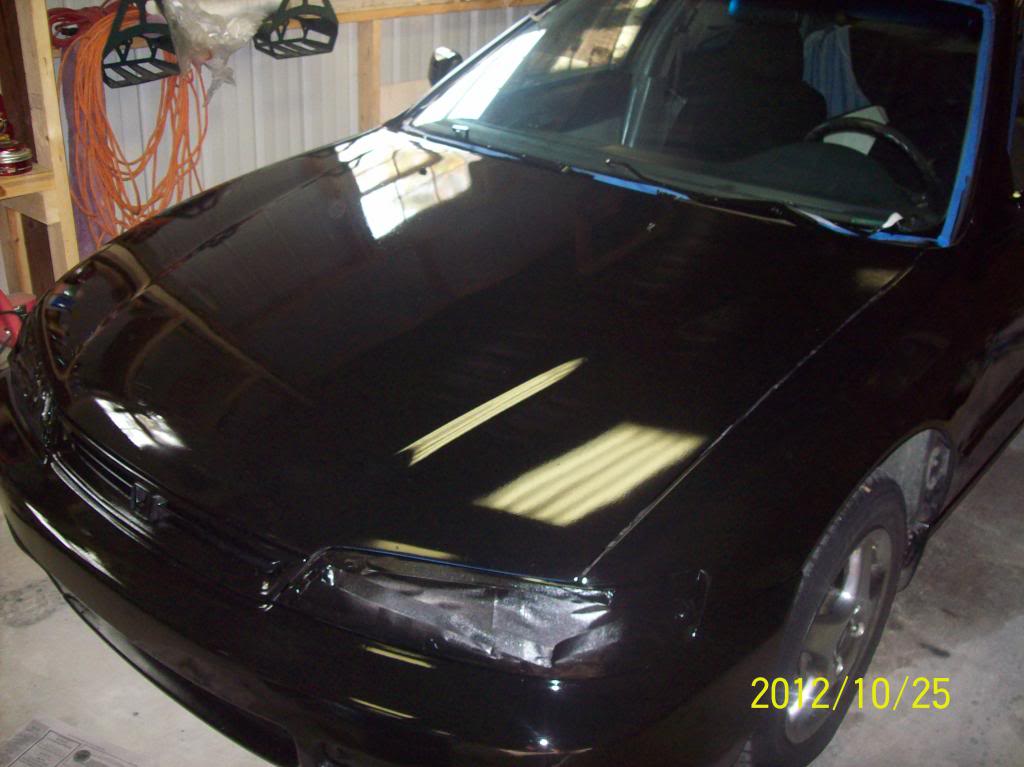

I sprayed it outside. I taped the car up in my garage, waited till it was calm out, rolled it out and sprayed it and then quickly put it back in the garage.
I used acetone as a reducer which flashes off real fast which makes the paint dry very fast which helps so the bugs and dust that land on the car wont stick in the paint.
I used an enamel paint which is not a base coat clear coat.
A base coat / clear coat really needs to be sprayed in a booth.
