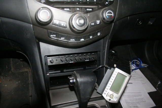

i need to cut a piece to go under the eq to fill that hole. i had one but i broke it. gonna cut another at work and i need to get that left corner clipped in. i was in kind of a hurry to finish it up before class. i had it put in a lot better the first time but i forgot to reconnect the a/c and had to pull it all back out. but you get the point and i am sure it isnt that hard to imagine what it will look like when i fix those two things.
edit: just went outside and looked at that because the gap was bothering me. it isnt a gap it is where the trim goes back in at an angle. not sure why my camera picked it up like that.

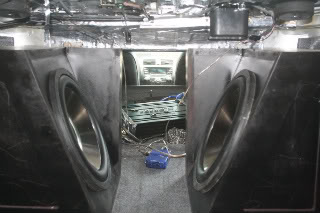

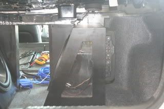

and for the smexyness my new boxes i just finished and got in today;
Size:  22.0 KBName:  IMG_1599.jpg
