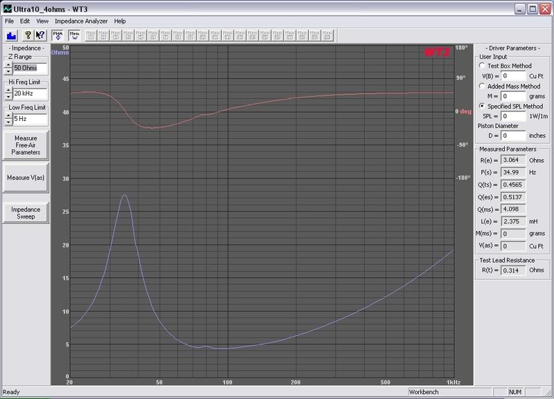

keep in mind that these are nominal impedance, and not actual impedance. actual impedance looks like this:
This is a 4 ohm SVC subwoofer. notice for how long the sub is actually 4 ohms. All subs/speakers look like this. You have a free-air resonance spike at the fs of the driver, then a gradual impedance increase due to the inductance of the voice coil.
