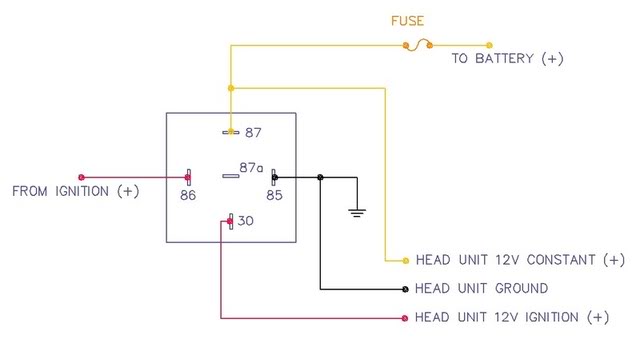

go to the battery for a constant. use a relay off an existing ignition wire to generate a switched/ignition (also off the battery).

Actually, it is resolved. I found it tucked way up in the harness. What a bitch that was.
