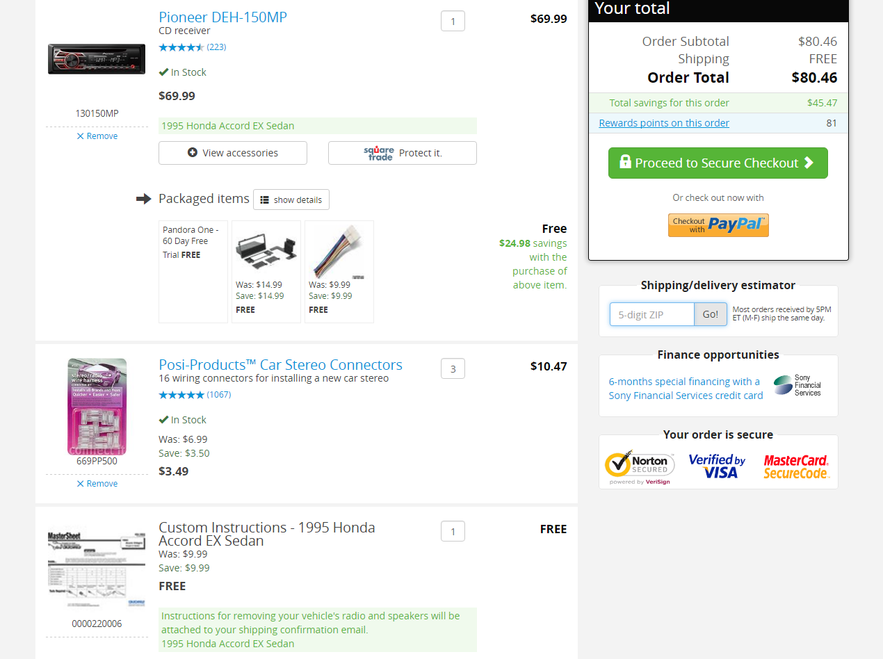

Anyway, for my mother's birthday I'd like to help her with her Honda Accord. Originally she had a CD changer in the trunk to accompany the OEM cassette/radio head unit in the car but the CD changer made it hard to fit large items in the trunk and died so we got rid of it. Also, at this point the tape player doesn't work either, and even the radio has poor reception, which is why this whole thing is long overdue.
Ignoring all the extra connectors (I'm ordering extras because I'm about to replace the stereo in my GMC Envoy), does this order make sense? I know that isn't a high-end head unit but since my mother will primary be using FM radio and an old walkman tape player through the aux port I'm assuming that sound quality will be the same as the OEM stereo if not better?

Welcome!
Honda's are super easy to work with, easier than domestic brands.
Replacement will be very straight-forward and the video and included instructions will make it a breeze. You are smart for shopping with Crutchfield.
Power antenna is the blue wire in the pioneer radio harness.
You may want to take a moment to consider the cosmetics of the radio. Your ma may prefer a look that is simpler, I usually look to Kenwood or Alpine before Pioneer or JVC. But regardless, the installation will be the same.
