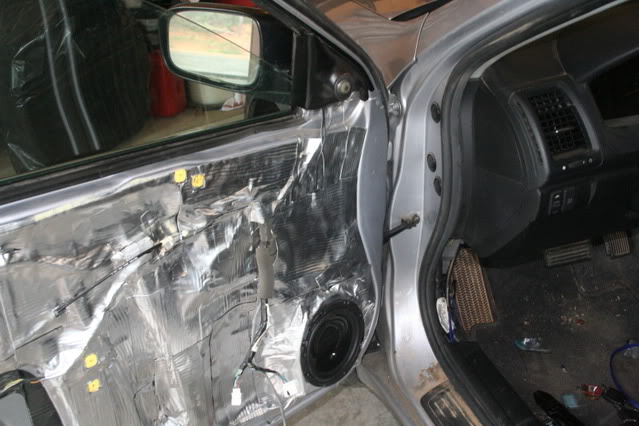

That looks good. I looked over your build thread and it looks great! My problem is that I already have stock tweeters in the door pillar and the after market ones don't fit correctly in the factory spot. I'm not sure how to go about mounting them...

I dont know what the 2011 look like on the inside. if it is anything similar to a chevy truck, what I did on one of my installs was remove the stock mounting piece. put a peice or 1/4 mdf on the back side and mounted the tweeter in that. then I put the factory speaker grill back in place. post a pic of your stock tweeter location if you can.

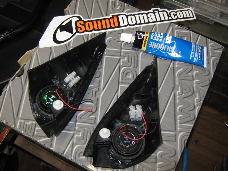

to hold them in place - silicone. not silicone on the tweeters, but silicone on the foam. the tweeter's will look like new if we want to remove them. a simple insulated terminal strip is a temporary connector until i order Molex plugs.
