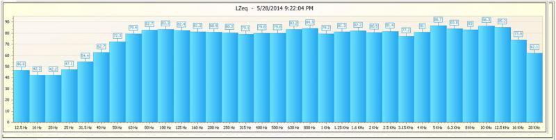

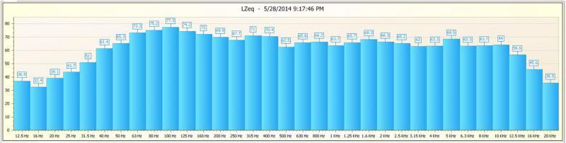

the stock system is fairly balanced and this was a measurement at the headrest:
this was in front of the door speaker itself

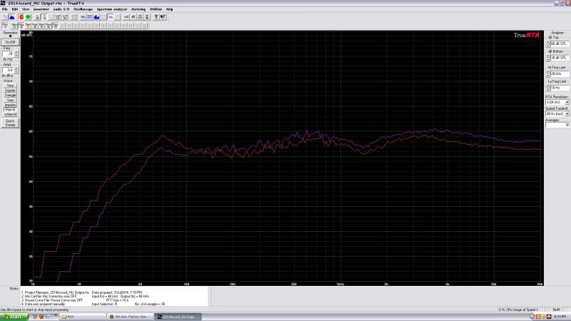

in order to achieve this response and also to allow the Active Noise Cancelling (ANC) system to function, there is equalization inside the head unit that looks like this:
you can see the bass roll-off in the output. you want an interface that can counteract this. you also want a remote bass **** that gives you control from the driver's seat. There are several products available that do this.
